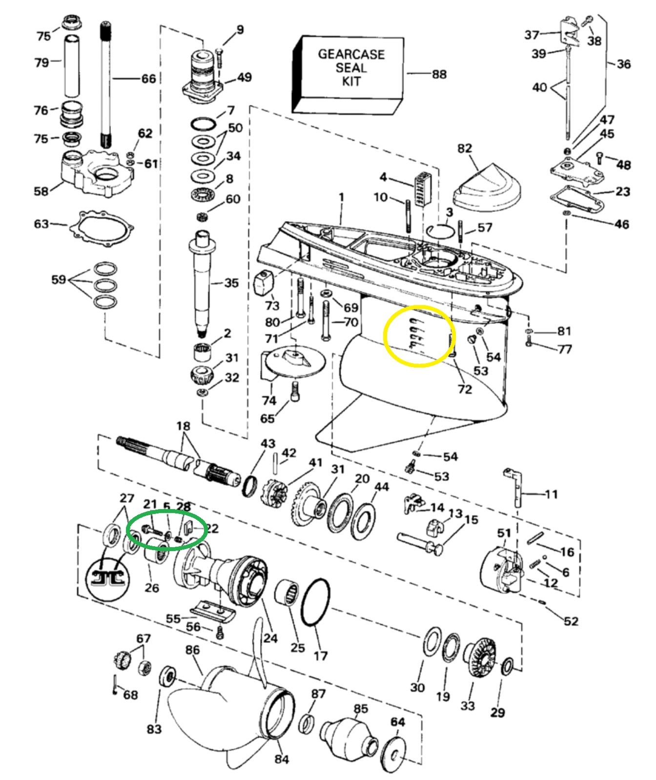

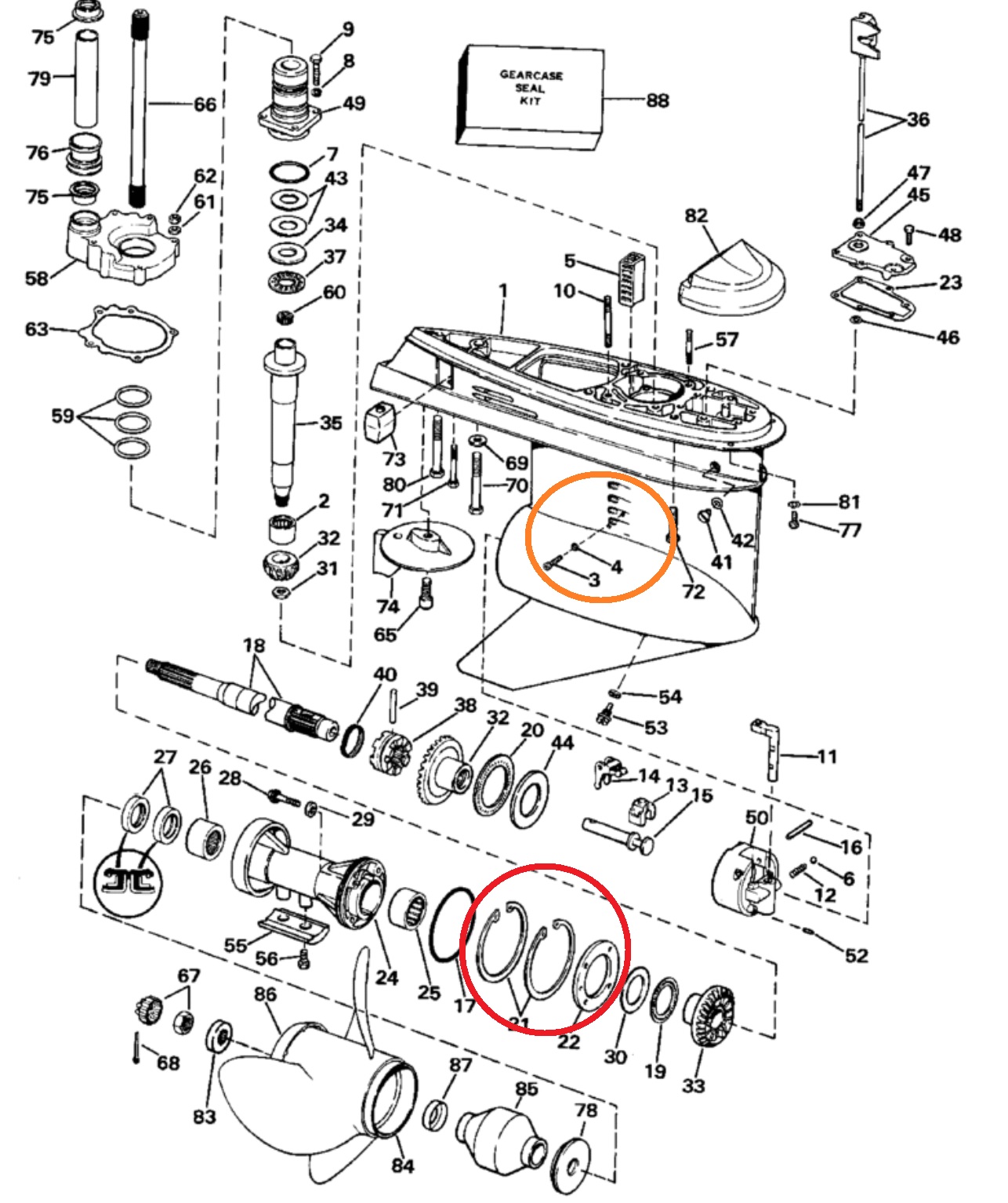

The lower unit is where I noticed the difference between the diagram and my outdrive. The major differences that are immediately apparent are the lower bearing carrier, and the retaining screw on the side of the lower unit housing near the intake screen. After looking through all of the OMC model year diagrams I believe the lower unit to be one from 1993, as that appears to be the only year that had the correct style bearing carrier as well as not having the retaining screw near the intake screen. The first diagram shows the 1988 model, while the second diagram shows the 1993 model which I believe is the correct model year for my lower unit.

1. The 1988 model uses snap rings and a plate which are installed in front of the bearing carrier, which the bearing carrier is then bolted to (circled in RED in first diagram). My model uses locking tabs behind the bearing carrier to hold it in place (circled in GREEN in the 1993 model diagram).
2. The 1988 model has a screw near the intake screen which must be removed for dis-assembly (circled in ORANGE on 1988 diagram), while my lower unit does not have this (circled in YELLOW on 1993 diagram)

Below is the parts diagram for the 432APRGDP which is the 1988 model number on the engine.
Below is a diagram of a lower unit for a 4.3L from 1993.
