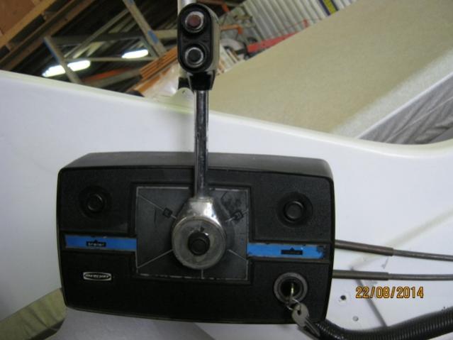

I have the control box shown in the pic. My boat is at work atm so I can't check to confirm until Tuesday but I don't think I have any unused terminals on the switchbox but I still have the white wire spare on the engine side. The previous owner had done all the joins for the new wires right at the plug so it was difficult to confirm 100% what colour each wire was when I replaced them.
The reason each wire wasn't tagged was because the marine mechanic who dismantled the engine to replace the bottom crank seal , decided it was not worth repairing and he obviously thought he knew where each wire went. However I am enjoying having a go and doing it myself.

I used an identical control on my '69 Merc800 until I moved it to the Shakespeare.It was plug in and go,to install the kill-switch I had to put jumper on the orange wire to the distributor side of the switch-box.Does it have the cobra head?
Just reread you post,you should have a spare terminal on the switch-box.The brown wire now goes to one of the alternator/stator terminals on the rectifier,unless you have one of the old Mercury tachs
