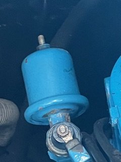

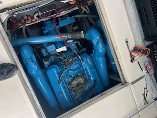

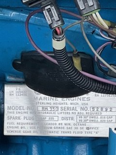

The port side engine was replaced right before I bought it. It is a model RH350. The oil pressure has always ran high on that gauge and I was told it is most likely a bad sender. I went to replace it and it wasn't budging. It is attached to the motor with a right angle clip. When I was attempting to loosen it, the clip and whole assembly was bending. Is that normal? I figured I would stop and research some before breaking something. I was trying to remove it with a wrench right underneath the cylinder. I have attached photos.

You need a second wrench to hold the block that the sender is screwed into while removing the sender
Thank you so much! I thought it might be that simple, but a lot of senders I've seen while doing my research are screwed right into the block. When I saw this, it made me question everything! lol
Crusader ran a short hose from the oil port in the block to a t fitting so it could have an oil pressure sender and a second low pressure sender for alarm/light. Make sure you get the correct sender, they look the same but there is one sender for single gauge, and a different sender for dual stations
