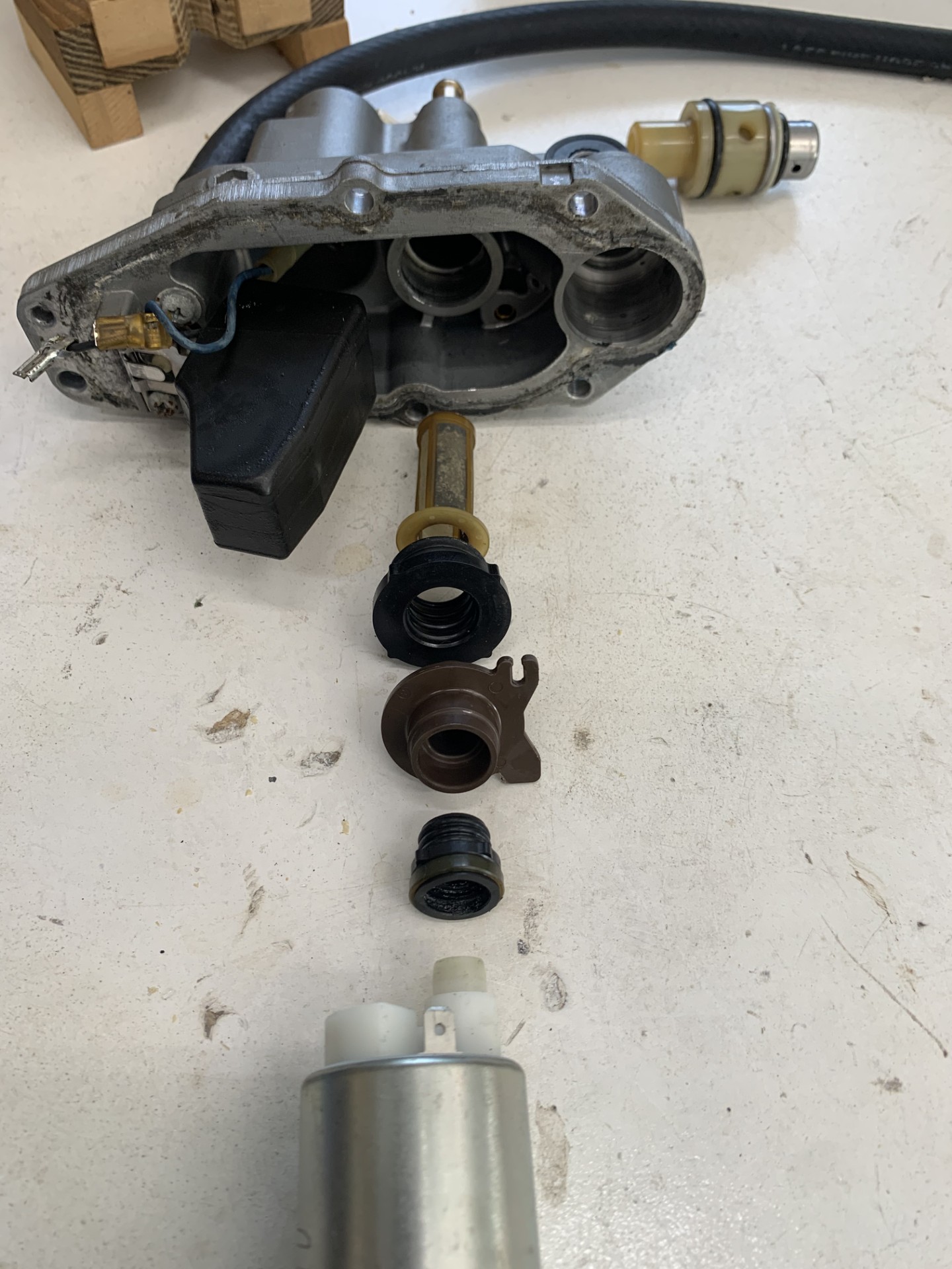

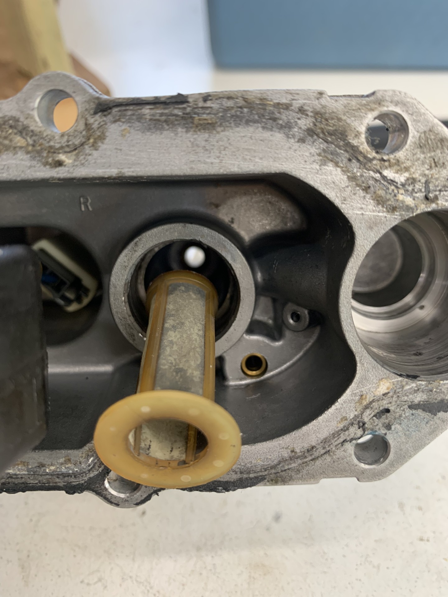

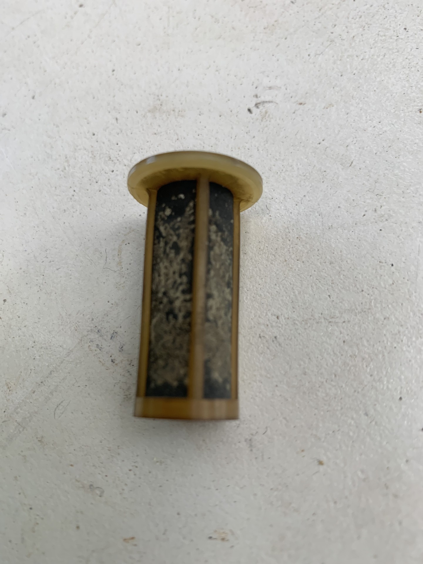

I've had a problem with restarting my 2017 Suzuki DF140A after it ran great for several minutes. I replaced fuel/water seperator filter, external fuel filter, both low and high pressure fuel pumps, fuel lines, primer bulb, and fuel tank check valve. But today I finally found the problem and wanted to share it. Inside the VST on the output side, there is a hidden hi-pressure filter/screen. Here are the pics to help you out.
Never would have guessed my problem was a due to fuel flow since once it finally started, it ran great.
