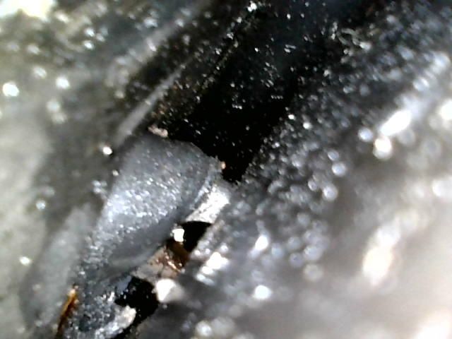

Been busy with a family thing. Got the pump put together and after three attempts thought I had t shift rod connected. Can’t see in ther, so I got a miniature camera. Haven’t got it yet. Any tips?
It’s in reverse. The first photo is from underneath. The second is the top.
Put lower unit in NEUTRAL.------With that lever vertical , see if you can engage the hole in the rod.----An assistant to move the shift rod front to back may help in aligning the hole to engage the pin.
