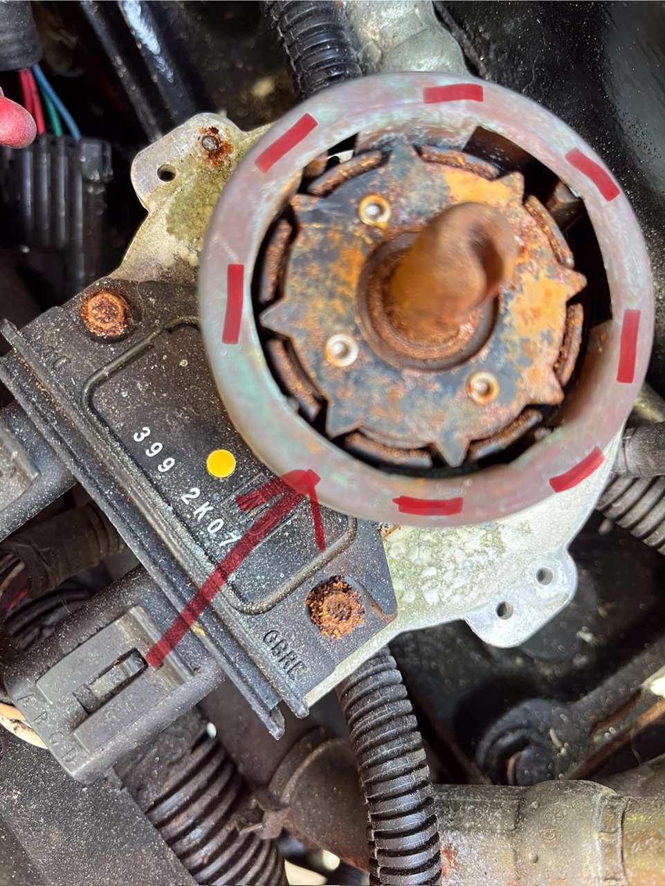

Then she showed me how an outer ring or shield around what appears to be a reluctor wheel is loose.
Should this be loose?
Is it just a shield?

Thats a Delco EST distributor...and it is a shield...and it shud be tight...
You can buy a new one fairly cheap...
A new shield or a new distributor?
Is there anything “marine” specific about this distributor? I noticed it’s not gasketed like my distributors in my 7.4L Mercruisers or my Sanger w/ONC Cobra.
The whole distributor is easier...from what I have seen, even the original DELCO units never protected the internal parts very well from corrosion...once they get some age on them, the corrosion process kicks in...If you can't source one, send me a PM with your email.
The gasket isn't as important as the screening on the vent holes....I have found nothing mechanical on those distributors that was marine specific. I suspect that the original DELCO modules had marine specific versions but they never release the tech data to validate the idea. If the ECU controls the timing, the module part number is irrelevant.
EST dizzy is very reliable, even when rust is seen.
Most cases when they fail it's the module, and module can be picked up from local parts house or GM. Try not to get one from Amazon unless you know the seller
