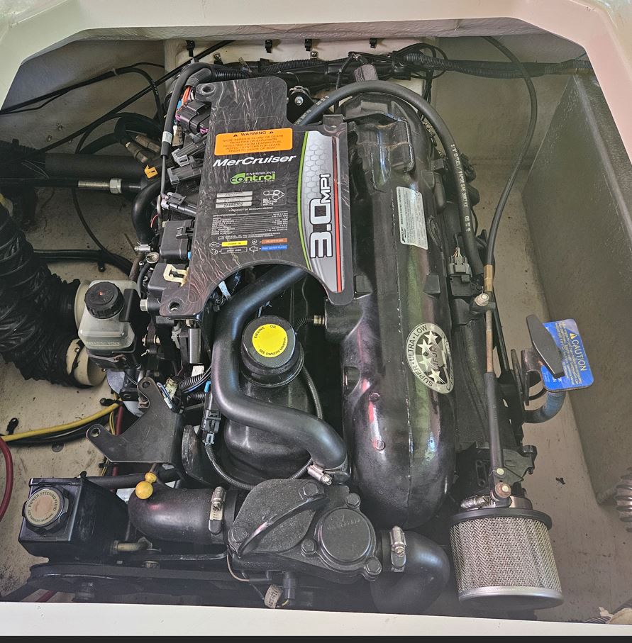

Started with a left hand turn while out running the boat. Will start right up and idle perfectly. When applying throttle, engine will not take full throttle. It will lope like in limp mode. All filters have been changed. TPS was changed, no effect. Could it be a tilt sensor? Where should i look next? Could it be a wire short?

What's the model of the engine? Can you post a photo?

It is a 2013 3.0MPI with 175 hours on it SN2A047033. I have the manual, but can't figure what is wrong. No codes, starts right up, but wont increase withput going into some sort of g
It is a 2013 3.0MPI with 175 hours on it SN2A047033. I have the manual, but can't figure what is wrong. No codes, starts right up, but wont increase throttle without going into some sort of guardian mode. So if i hook up the pressure gauges, I won't be able to do WOT and not sure i can do 2000rpm. Where is the valve located to hook up pressure gauge? Wont let me attach a pic
