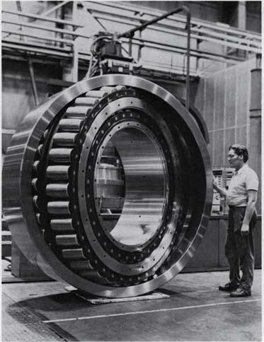

And be grateful that you are not replacing one of these giant bearings! :D
