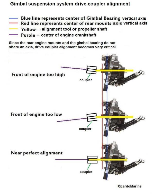

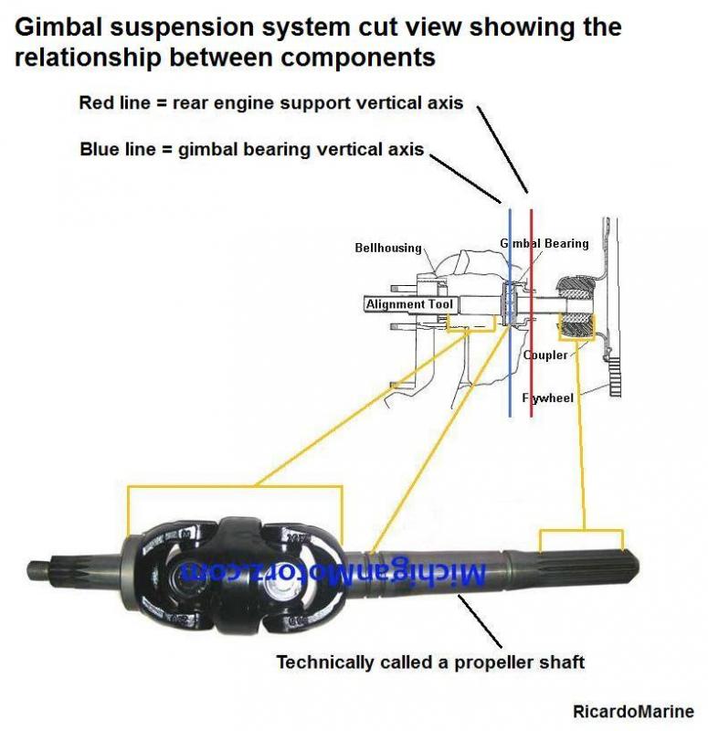

Here's an example of the geometry and the goal!

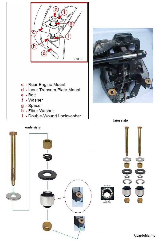

Check to see if you can turn the fibre washer or check if the upper and lower housings are basically touching.Post some pics if you can.
Rick,
Thanks for the pictures that are a great help. Still trying to figure out exactly what the problem is and how to solve it. Yes the engine is out of alignment but what actually caused it and how do I fix that?

There's no adjustment to the rear mounts. You should double check that all is in the correct order and seated into the recessed area of the transom plate mounting bosses.
The main adjustment is at the front of the engine. There shouldn't be much side to side discrepancy, it's mainly up and down to align the axis of the crankshaft with the drive.
Are you sure that you're reading it right? If the coupler looks high that means the front is too low. Bringing up the front will lower the back end. Does that make sense?
Also, when using the alignment tool, you should be putting a skim of grease on it as a way to tell where the high spot is. I'm sure you know that just double checking.

Thanks for including the diagrams of the mounts. It's always handy to have these at the read just for comparison.

A quick note about the rear mounts.
Just for clarification, I have the Original Design Mounts in the boat now.
Do you know if the new design mount will raise the rear of the motor any higher than the original design?

My thoughts are...... if you did not replace the actual mounts (in the inner transom plate bosses), the rear engine elevation should not have changed.

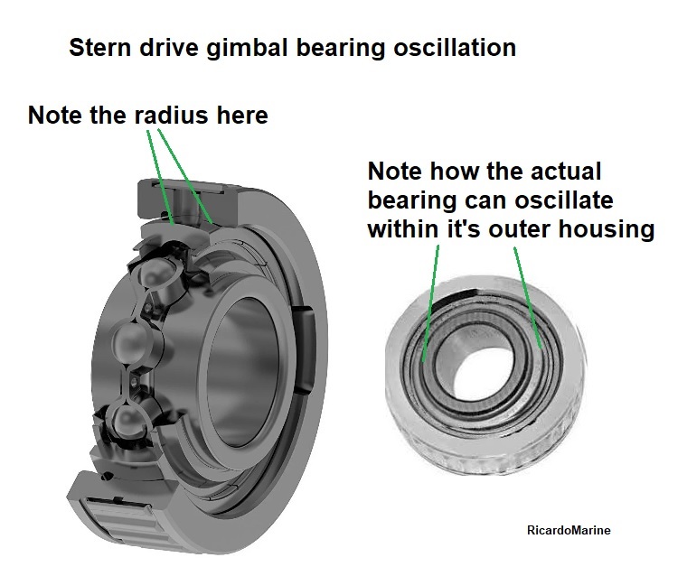

Also, keep in mind that the Gimbal Bearing's inner race itself articulates in an orbital fashion.
When the drive was removed, the inner race may have been repositioned.
If so, when you insert the alignment tool, you might be sensing the inner race having been repositioned, in which case you would adjust it with the tool.
That said, if you can fully insert the alignment tool through the Gimbal bearing and into the drive coupler, this would not be an issue.
There will be no difference in height at the rear regardless of whether you use old or new, but since you reinstalled what was there, we assume that no dimensions are different from before the parts were replaced. Again if the hole is high at the rear you want to RAISE the front of the engine.
I have installed the new type replacing the old style and it does not change the height ,if any. I believe the new type is longer to compensate for it because the doublewound is not used and a SS washer is supplied if necessary to make a minute correction.
Did you install new rear mounts? If yes, were they installed correctly?
it will change the height ONLY if they have collapsed

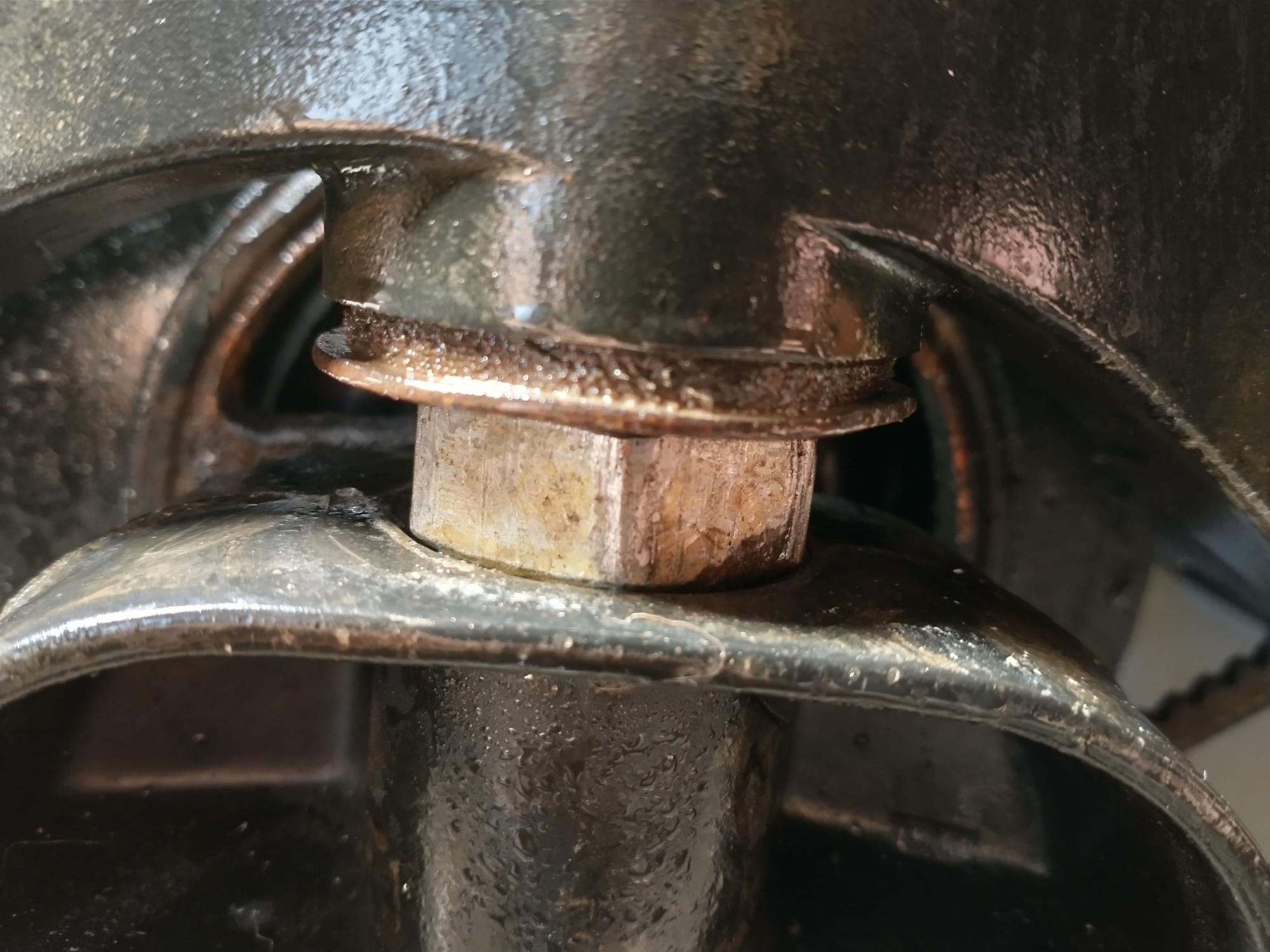

All I can be sure of is the front jackscrew adjustment is all the way down on the motor mount and there is still a slight misalignment? See pictures attached
BTW, I check the fiber washer on the rear mounts and I am not able to turn or move it. Also, the rear inner transom mounts and the rear engine mounts appear to be incontact with one another with the fiber washer being in between the two... Was not able to get pictures but will tray again later...

remove the rear bolts and check the height of the top of the rear mount in relation to the top of the flywheel cover. I`ll take some pics of the housings I have for comparison, you can also measure between the RED lies
