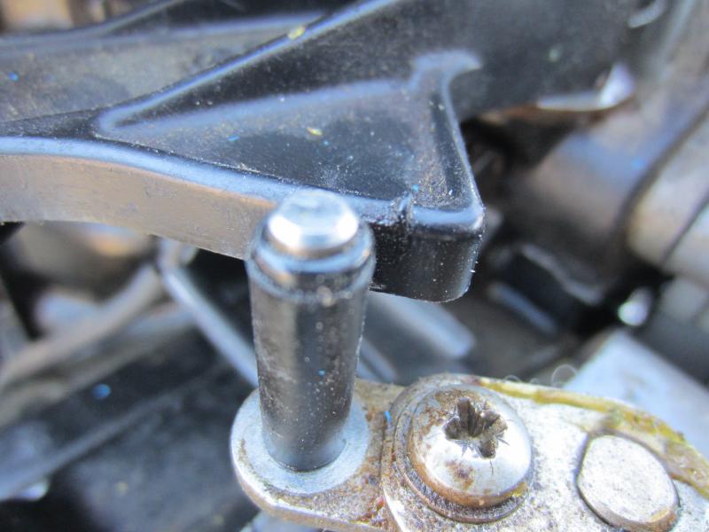

It will start then idle for couple of seconds then die. I have an issue when moving from a higher RPM back to idle. If I take it up to higher RPMs while in neutral, it will run fine, but when I drop it back to idle it will die. If I drop the RPM back quickly from a high RPM to idie it will most certaily die more easily than if I ease back on the throttle with a slow decent to idle. I also noticed that in neutral the cam follower mark and the roller is not aligned dead center with the roller (look at the photos). The outboard runs fine otherwise. I have a feeling this could be related to synch and linkage problem? Can anyone give me tips? Shift/throttle cables binding?
