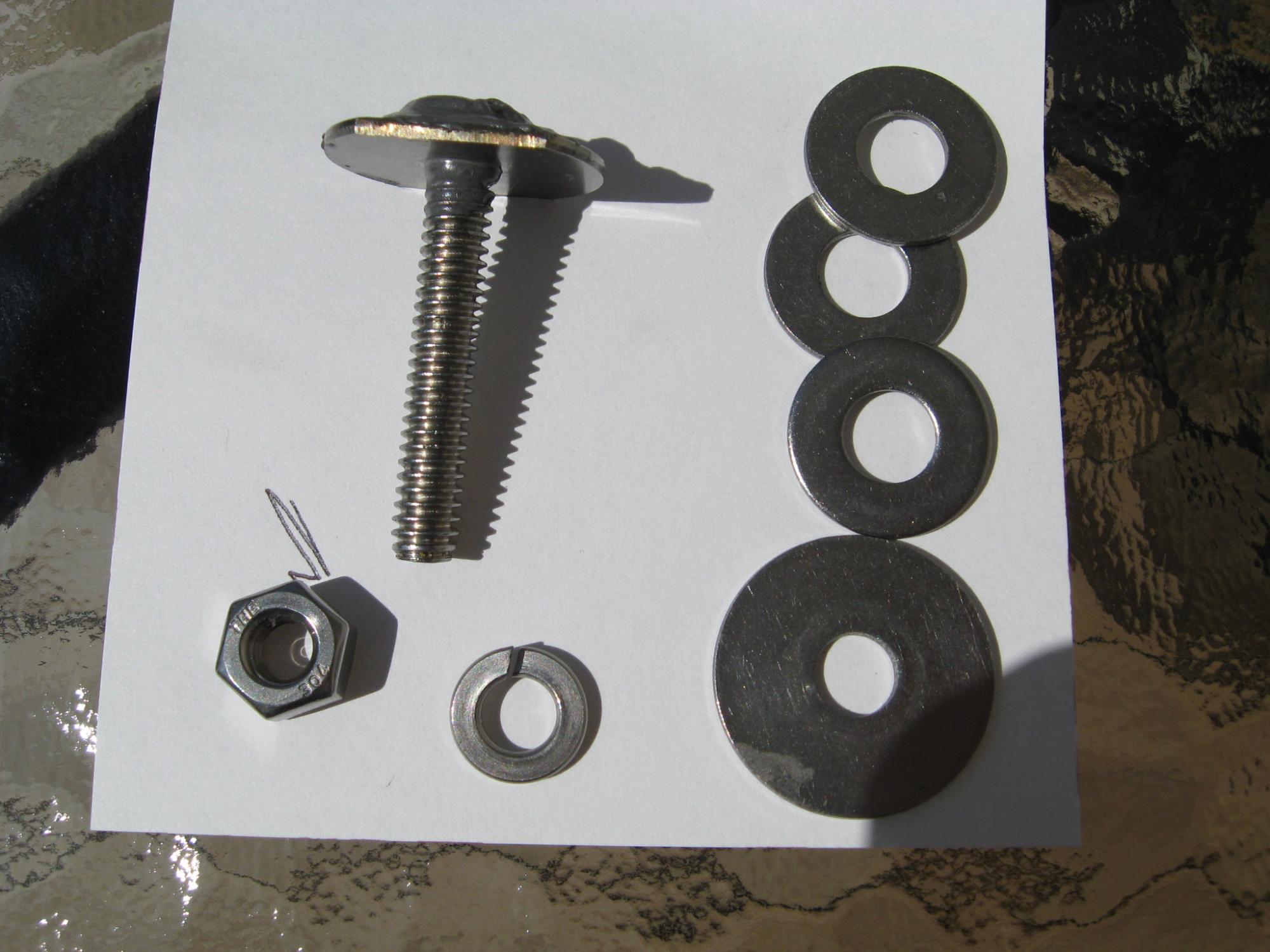

Here's what I did. Parts list shown and description. Seems to work fine. Didn't recognize till after assembly that the bottom washer wasn't completely covering the hole (see pics) so I'll correct that next time I have the lower unit off. I'm going to call it 95% covered !! LOL
