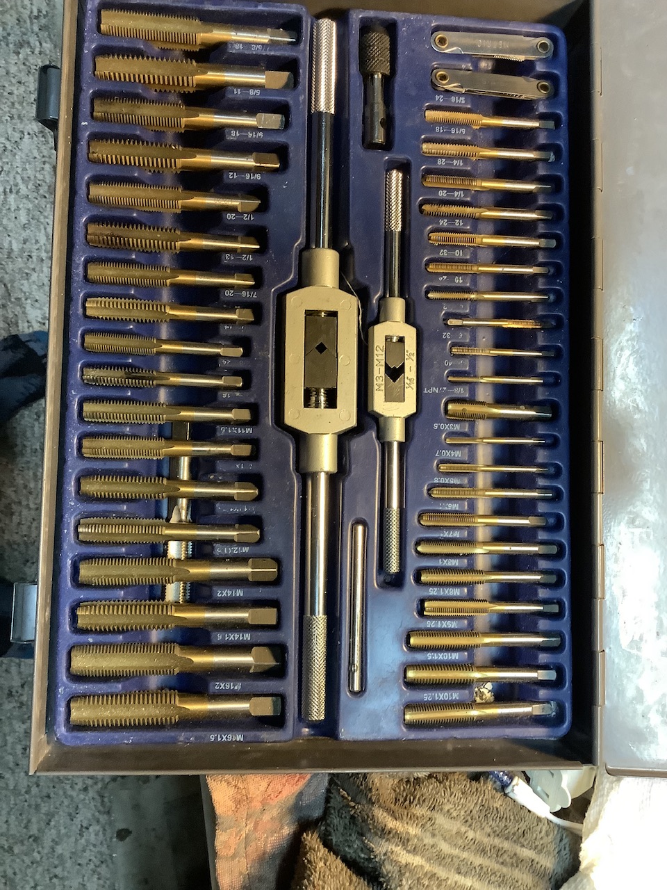

Makos explanation is simply the way to make a po-boys tap. It wouldn’t be as strong as grinding 3 grooves into a bolt, but you’re only dealing with plastic, (Teflon), so it’s fine. If you elect to make one, I’d turn a nut all the way down the bolt before you grind a groove. When you remove it, it will clean up the threads.
If you have a tap/die set, you probably have the tool required.
Notice the grooves on the taps, they allow the cuttings to be removed from the bore, which is what slicing into a bolt does.
