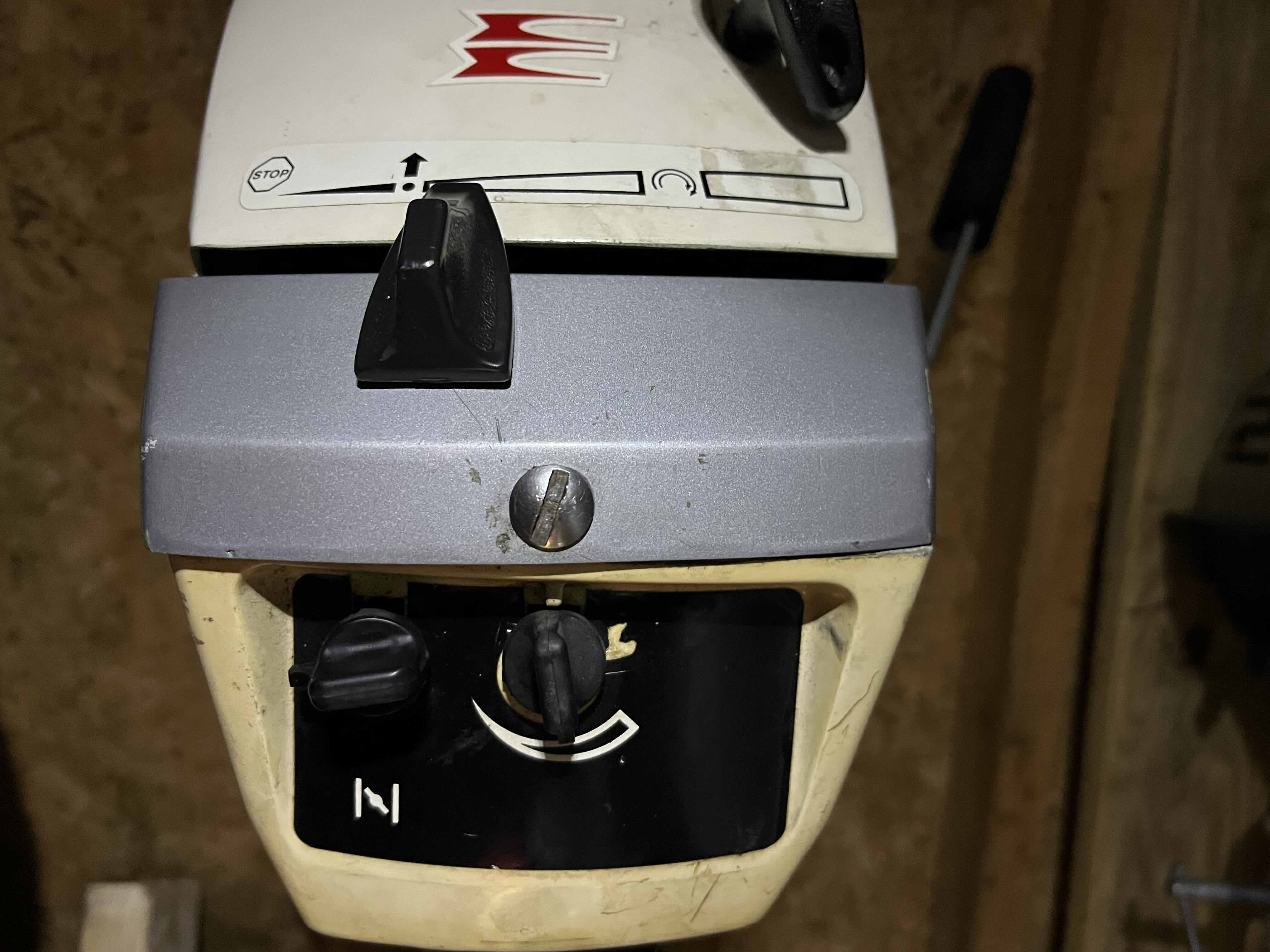

Here are some pictures of my motor. Heard that the 8 holes on the back of the leg might be where the water from the cooling system might come out, mixed with the exhaust. Was wondering why there wasn't any clear water flow coming out from the engine compartiment while it was running today (in a barrel of water) as I've seen on most of my past outboard motors.

You need to change the impeller FIRST. These engines will only have a noticeable mist from the holes you mention. Make sure the holes are not clogged.

Marine engine.com has excellent diagrams on their website. As your engine is shiftless it is only a matter of removing the lower unit bolts and removing the unit. Be careful not to break the bolts. Aerokroil penetrates very well. There are videos on the internet that can help. Really simple repair. Be sure to clean/clear out the water passages. After you replace the impeller you should see water misting and drizzling out of the holes you mentioned. This engine does not have a thermostat. If I can help you further please let me know. Good luck and enjoy your engine
