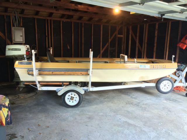

BTW, here are some photos. The one with the truck is the day I picked her up. Craigslist purchase for $1100.
Next photo is after some elbow grease on the finish.
Foam out! Finally
