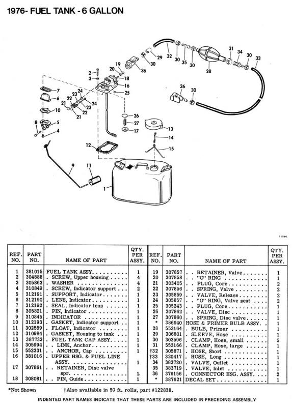

Aha! So do your tanks have the two little pins that get pushed in when you plug on the hose? The pin with the little brass washer around it has a teensy o-ring behind that washer. O-ring goes bad and it sucks air. Take it apart and replace all the o-rings. (Access by removing the round core plugs on the back side.)
All this is assuming the o-ring in the fuel connector is good. But you said it is new.
