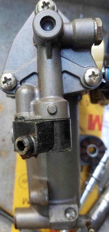

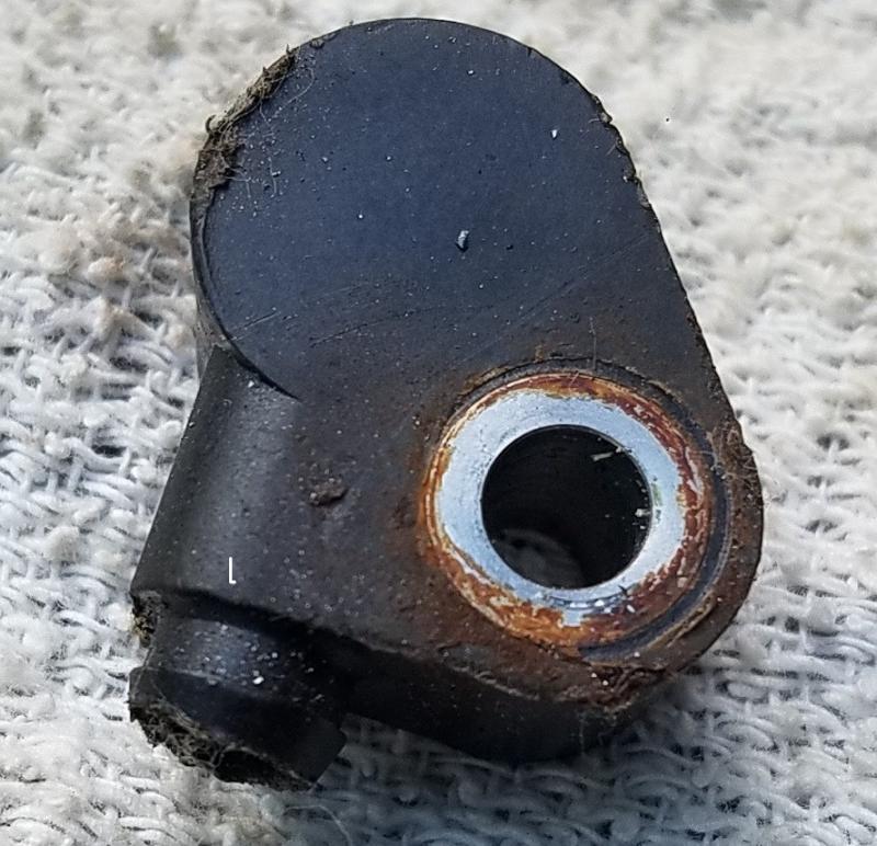

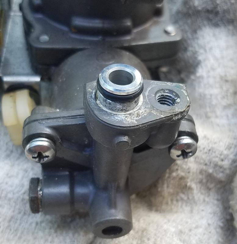

Hi everyone, I am in need of your help again. I couldn't free up the screw on the VST to drain it on my 2006 bf 225 hp. I tried drilling it out but that didn't work, so I am just going to change the pump case. While disconnecting all the hoses on the VST, I broke the fuel line connector on the bottom of the cover where the filter goes in.
Can anyone please tell me where I can find it in the parts diagrams, I can not find it.
This is the connector I broke. Thanks in advance

16755 ZY3 003, you have to purchase the whole pipe from the vapour separator to the top of the starboard fuel rail
