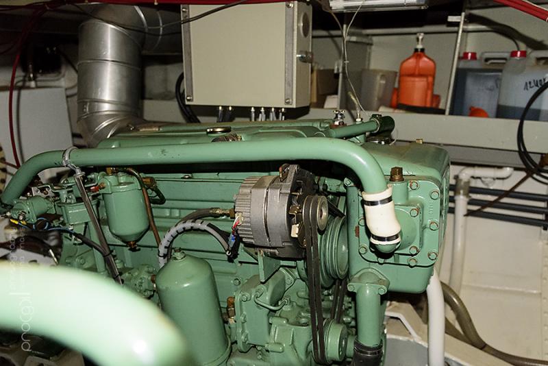

I amintending to buy a steal boat from 1962 completely restored 15 years ago
but onlyused for two years so the boat is inside a hall (not warmed) for already 13 years.
Two enginesGM 4.53 who were overhauled also 15 years ago.
Myquestions is: is there a possibility those engines are still ok?
How to findout?
Thanks alot for any advice
Walter

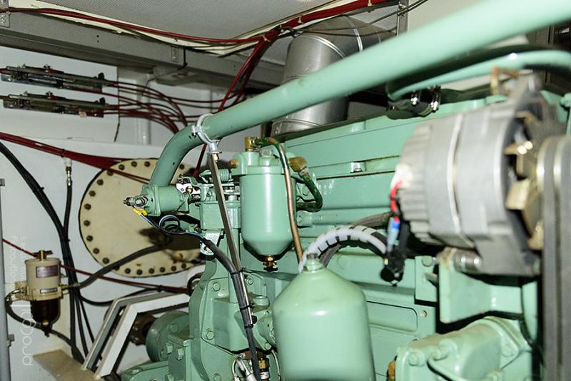

They should be fine if they were fogged and stored with fresh oil in the crankcase. Even if they weren't fogged, if they sat with fresh oil they should be ok.
Engine bearings and crank journals immersed in used oil may experience "etching" from acids that develop in oil that has been heat cycled and contaminated...primarily with condensate water. The cleaner the oil seems, the better. If it's black, it might be worth your while to pull the pans and look under a couple of caps....at a minimum. Either crank them over several times with the governor in no fuel/stop or use a pre-luber to oil the upper end and prevent a dry start. Keep a weather eye on oil pressure during first few hours of operation.
Make sure you do a flush of fuel lines and polish the tank(s). That along with new filters should
Take care of the fuel system and remove any "bugs" that may have grown.
Cooling system is simply drain and fill . I would also consider new t-stats. Keep an eye on pump seals and temp during run in and you should then be able to enjoy these two reliable old workhorses for many hundreds of hours.
Good luck.
Hire a reputable marine diesel mechanic to do a complete survey on engines and gear reduction units assuming it is a twin screw setup. He will be able to do the initial spin up and bleed the fuel system if necessary.

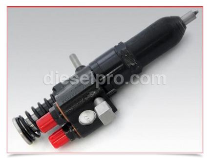

Detroit 2 cycles work by the blower pressuring the air box. Each cylinder has sleeves with ports at the bottom of the stroke open to the airbox and opened or closed by the position of the piston. Both valves only open for exhaust. As the piston nears bottom, the ports become exposed and fresh air enters and goes into and up the cylinder, thru the valves, pushing out the exhaust and creating a fresh charge of air. As the piston rises, the ports are closed and the air compressed. Near the top, the cam via a 3[SUP]rd[/SUP] rocker arm causes the injector to spray fuel into the cylinder, igniting and making the piston go down.
Don't take out the injectors unless you know how to set them. They require a precision setting. Improperly done and the engine may not fire or it could runaway. Rpm is controlled by a governor. When you change throttle position, you're only telling the governor to run the engine at a new speed.
Fuel is controlled by a rack under the valve cover. It is important each cylinder gets the same fuel amount and the engine can be shut down.
Before you start, make sure the rack and the injectors move freely. See pic. The silver item going thru the injector is controlled by the rack. These all need to move freely. As the rack moves these control how much fuel is injected. To move the rack by hand you will need to disconnect the rack from the governor. Don't try to run the engine this way! If any are stuck with age, pull the injector and have an injector shop or a Detroit mechanic look at it. If all injectors and both racks move freely, reattach the governor, circulate fuel as I said before and go for it.
The injector has 2 fuel lines, in and out. The head has fuel channels and fuel always circulates thru the engine and injectors and back to the fuel tank. Detroit Diesels pump much more fuel than they use. I don't know your specs, but on 671 they pump 35 gallons/hr. This preheats the fuel and also means the fuel goes thru the filters several times.
If you have 2 water pumps, one is coolant and one is salt water. The impellers may be bad because of age in the salt water pump. Also, the seals could be bad in all the pumps. They can be rebuilt. The blower produces about 2 atmospheres, but not at startup. Diesels start because air temp increases with compression to above the ignition point. Until the engines have been run and warmed the rings may not be fully seated from sitting. If they have block heaters use them for a couple hours before starting. Any increased warmth will help heat lamp, heat gun, heat the engine room, etc. Use any ether sparingly. It greatly increases compression and can crack rings. Do not try to run the engine on ether if it doesn't start.
Engines with stuck injectors/racks can runaway. It's not common, but can destroy an engine and everyone near by. Have a plan. Get many rags to put in the intakes or some method to stop airflow, Some engines have an emergency stop on the blower or intake. If yours does, make sure it moves freely.

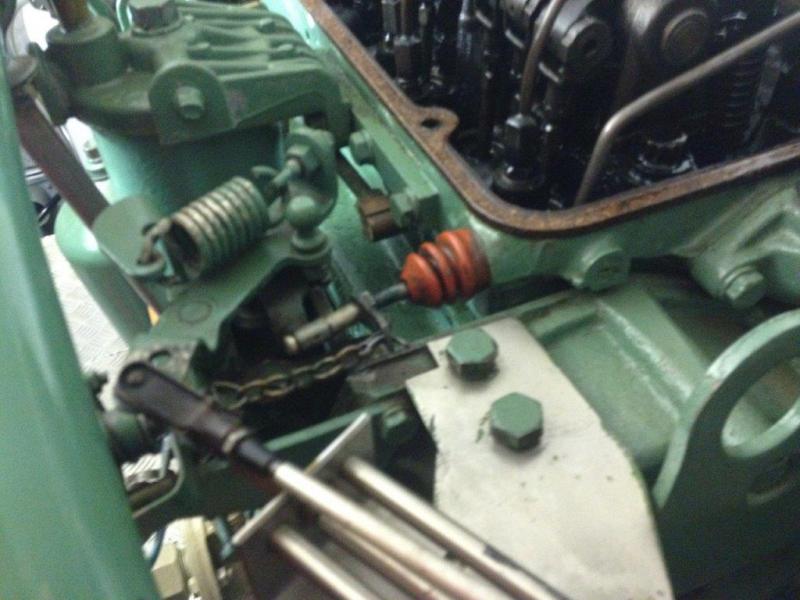

I did not disconnect the governor but I could move governor rod for a big distance to the off position,
everything is full of oil and looks to go very smoothly so the regulators from the injectors seems to glide fine.
When I turned the crankshaft manually, the injectors make one by one a prrt sound, I suppose this is a good sign?, that they are still in working order?

I admittedly am not fully comprehending the throttle linkage from these pictures but it looks like everything is there and, from your description, sounds as if there are no stuck injectors.
Sounds like you're getting ready to light her off?
Just make sure that YOU understand how the throttle linkage works, especially the shut down, and that you have a reliable way to deny air to the engine if it is not equipped with an emergency shut down system that works. A piece of 3/8" or 1/2" plywood with a makeshift handle attached that you can quickly slap over the air intake duct usually works nicely. If she does have an E-Stop, make sure you know that it is working and also how to trigger it manually if necessary.
Other than that, make sure the drive is in neutral and give her a go!
After 13 years, be ready for some smoke and keep a weather eye on oil pressure and engine temperature.
Good luck Captain!
I think there is a mechanical shut down, block the air intake?
see pictures in the two positions possible (pictures 4687 and 4690)

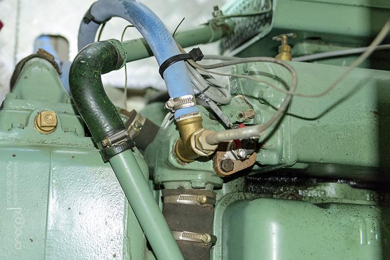

Then I was wondering what this filter housing is, filtering the closed circuit cooling water? (4677)
did not open yet
never saw this on a other engine
Does anybody know if there are zinc anodes somewhere? inter cooler?
