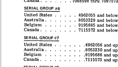

Shane,
Is a US motor (not Canadian) 4 cylinder?
If so, see 4357640-thru-5531629-usa
See gearcase group 7 drawings.
Confirm that looks like your application.
If so,
OEM kit should be 46-77177A 3 - Water Pump Kit
Sierra 18-3324 - Water Pump Kit
