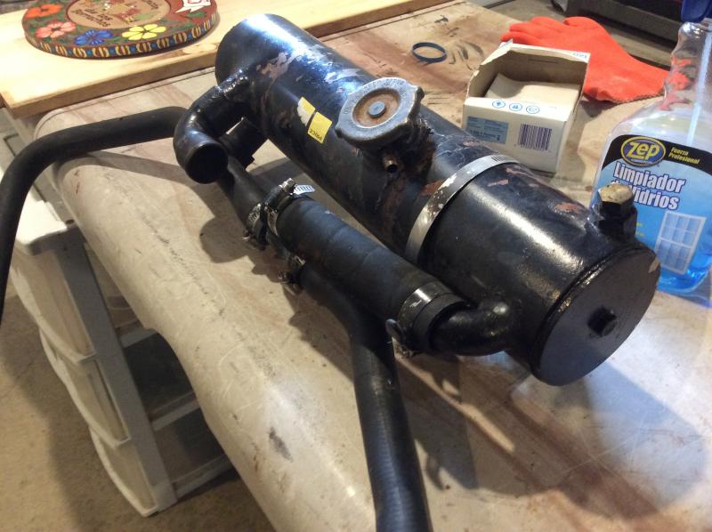

I Want to put heat exchanger on my 5.7 mercruiser. got it figured out but don’t know what to do with the exhaust hoses to the risers?can I remove them and put a plug in the riser?see photo .Are the lower hoses enough for exhaust with a half cooling system? See photos.

I Want to put heat exchanger on my 5.7 mercruiser. got it figured out but don’t know what to do with the exhaust hoses to the risers?can I remove them and put a plug in the riser? see photo . Are the lower hoses enough for exhaust with a half cooling system? See photos.
From what I see, you have exhaust manifolds with spacers/risers directly above them, and exhaust elbows directly above the spacers/risers.
You also have what is called a "dry joint" system.
Your new heat exchanger is equipped with a single "spent" seawater outlet that sends the spent seawater to a T style diverter/splitter fitting.
This T style diverter/spitter sends an equal amount of "spent" seawater to each exhaust manifold.
Your spacers/risers will need to be equipped with open gaskets (both under and above).
The single "spent" seawater outlet and T diverter/splitter fitting prevents the system from sending seawater to the manifolds and elbows individually!
You will feed the spent seawater to each exhaust manifold, where it will then move up through the spacer/riser (open gaskets), enter the elbow where it will eventually go out with the exhaust gasses.
Compare the above with the instructions that you received with the H/E kit.

As for the H/E tube bundle interiors being serviceable, look closely at the ends of his H/E.
I see what appears to be the SJE style, center bolt, removable end caps.

Ita a mercruiser heat exchanger with both end being removable see photos.
Ayuh,..... 'n that only allows cleanin' the raw water side,.....
To clean the fresh water side, the bundle has to be unsoldered, 'n removed,......
.... and that only allows cleaning of the raw water side....
To clean the coolant side, the bundle has to be unsoldered and removed,......
That is exactly why at XX hours (20, 30 etc), the Heat Exchanger would be removed and the E/G (ethylene glycol) side would be flushed out with hot soapy water and so on!
So yes.... if a person installs a heat exchanger on a previously raw water cooled engine, and then doesn't to this flushing, then sure, you're going to have trouble down the road!
