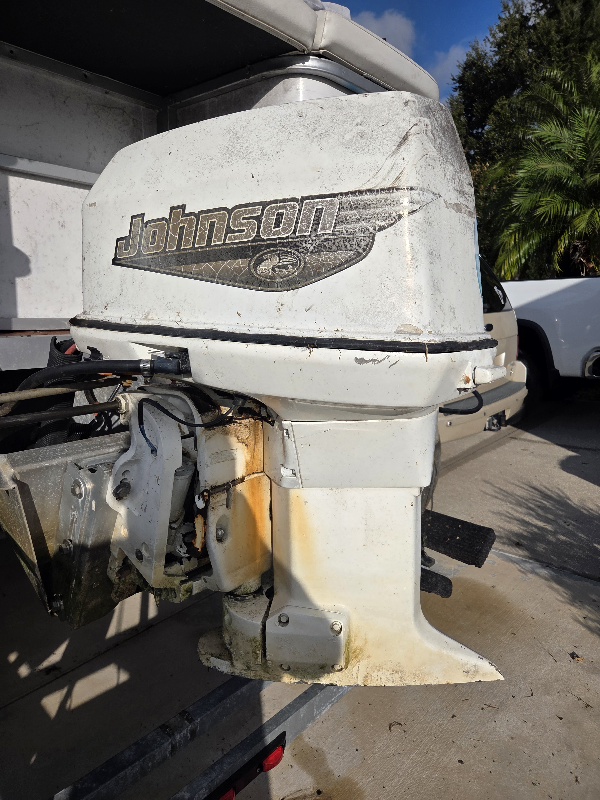

This is what I know... Johnson 90hp OceanPro (from cowl hood) 2 stroke, premix fuel. 22.25" drive shaft (tip to face of foot) 13 spilne prop shat, 5.5" long.

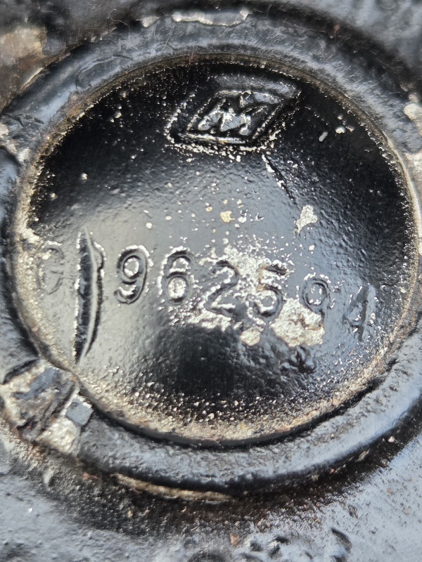

This is on a February 2000 manufactured Muarell pontoon. I believe this motor was only made between 1999 - 2001. Tag is missing on pivot bracket but I found some numbers on the block and freeze plug.

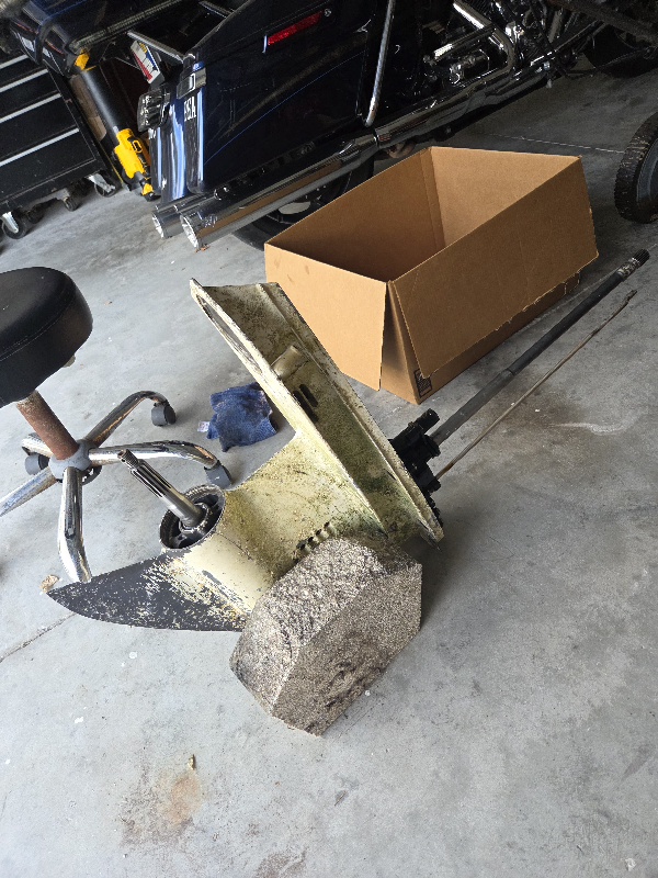

I need to replace or rebuilt the lower unit as reverse gear has failed. Gear sets are over $300 then add $50 more for seals, but I can but lower units for $150 complete.

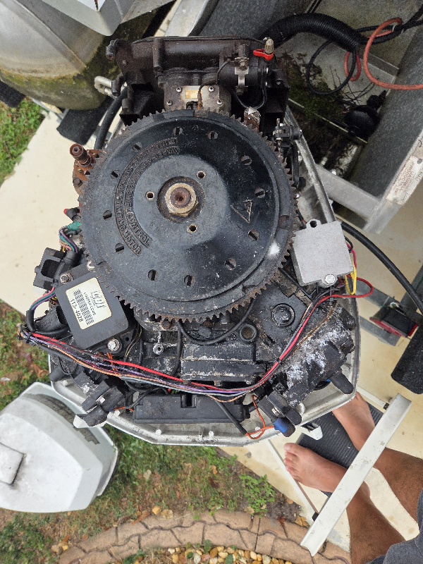

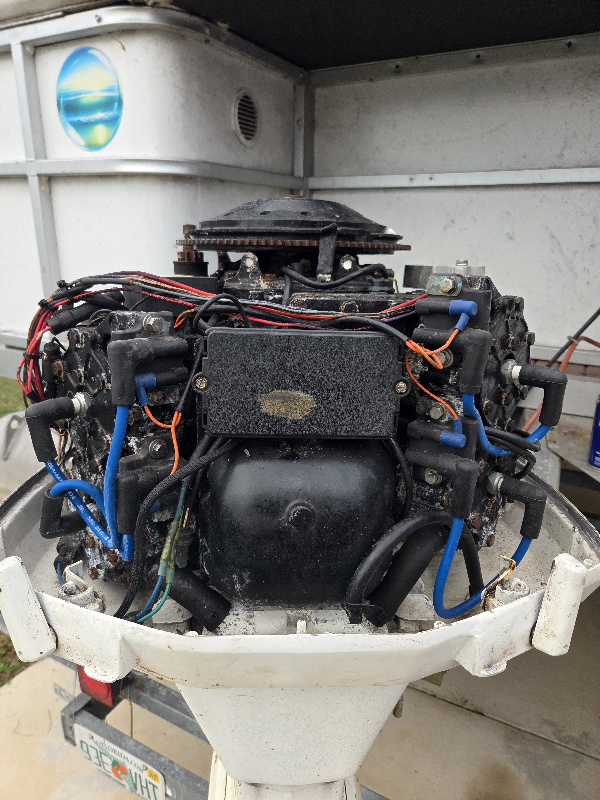

This motor model was last produced in 1998 !!------Likely a shift rod adjustment issue.-----Hard starting may be due to mistakes made in your starting procedure.----Start with posting exact compression values for further help.----Decals have been replaced to make it look like a 2001 model.------Lower unit is definitely / guaranteed to be off an older crossflow and not a 60 degree looper.----This could be a 1990 model.-----That is my humble opinion.

With the lower unit off i can shift to drive and it locks in, neutral is fine, reverse never engages. When it was assembled and on the boat it made a horrendous grinding noise shifting into reverse and never engaged. I just want to get back on the water cheap. What lower units can I use?
He knows because the motor is a 90 degree crossfow engine. The exhaust bubble and the fact it does not have the OIS ignition also tells you its a crossflow engine. The 90 degree V says it is wider than a 60 deg looper block. They were last produced in 1998 and were known for rings breaking. Which is why he asked for a compression test. It could be a 110/112 or 115 engine, essentially all the same.
