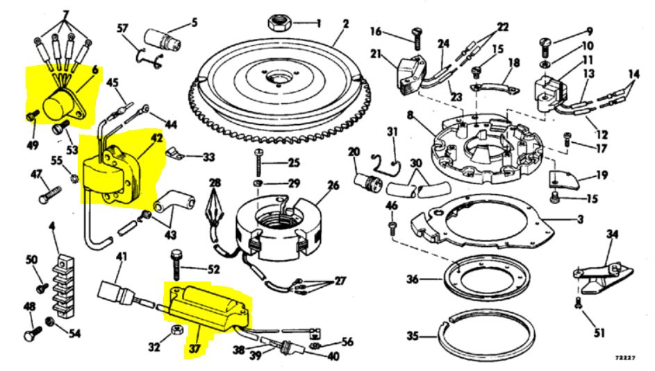

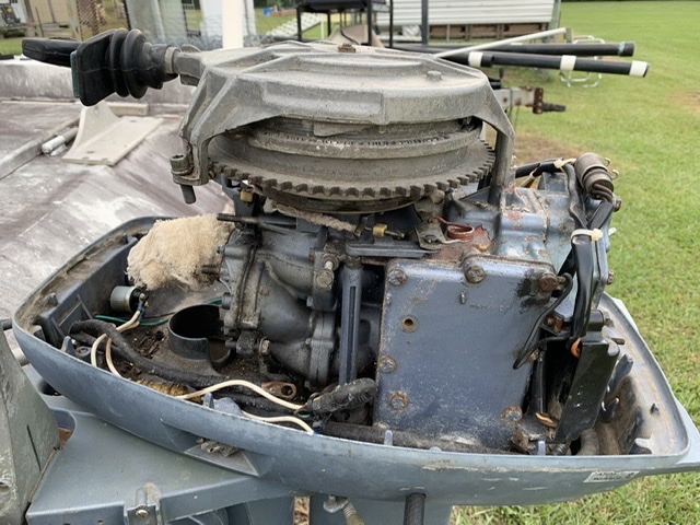

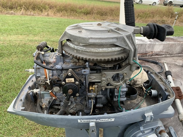

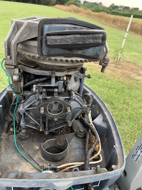

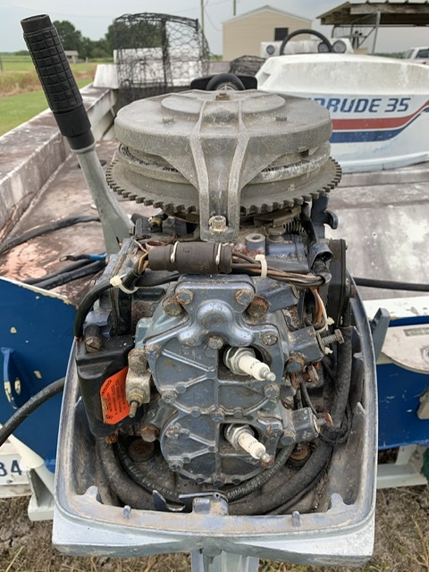

Help me identify which electrics are missing from this stripped 1977 Evinrude 35?
sss
Would like to verify all the electronics I need to order for this stripped 1977 35HP Evinrude.
I plan to order a rectifier(#6), 2 coils(#42) and I will replace the existing powerpack(#37) as well.
I'd like to try to reuse the stator(#26), charge coil(#21) and ignition sensor(#11). How often do these items fail?
I also plan to reuse the electric starter and choke solenoid(I have 2 solenoids to test and pick from). The starter has a known issue with engaging/disengaging the flywheel so I need todisassemble/clean and inspect to see what I'm getting into. The flywheel teeth aren't worn, I need to check the starter drive gear.
I'm not sure on the wiring harness yet. I may need to build or replace portions of it.
What am I not thinking of? Thanks

Have you removed the flywheel to see what parts are there ?------Any other trouble shooting / inspection done on this motor.----What if you spend all the money and find it runs poorly ?
Do a compression test first . as racerone said, that would be alot of money with no compression.. I just fixed a '76. 50 hp. Their is alot of old harnesses out there. We have plenty. ( fixed motor all used parts)

That’s the kind of help I need. What does a rectifier do? It’s listed on the schematic but I don’t know why. Thanks
So from what I’ve read, I don’t need the rectifier if I’m not interested in charging a battery, correct?
The charge coil and ignition sensor, are these items that need replacing often or should I not worry about starting off with fresh ones?
The only thing it looks like you are missing is the ignition coils. You should be replacing the forward gear also. The shift rod bent because it was jumping out of gear. The bushings wore out because there was probably water in there.
