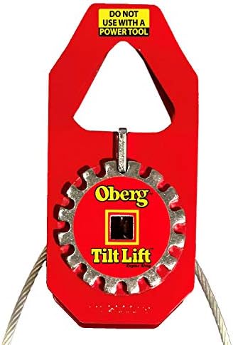

There's only one way to handle engines:
https://www.amazon.com/Oberg-Tilt-Lift-Engine-Sling/dp/B002LXQUPS
I believe the heads have bolt holes machined into the ends. Use these along with the Oberg sling and you'll have a balanced engine (right to left) that you can tilt easily with a 1/2 inch ratchet or bar. The Oberg gives you micro adjustment. The crank type slings get really hard to adjust when you get them loaded up.
I have been using the same hunk of 3/8 chain for 20 odd years until I learned about the Oberg sling. Boy that thing sure makes life easier.
If you wanna borrow mine, you just pay shipping to and from.
