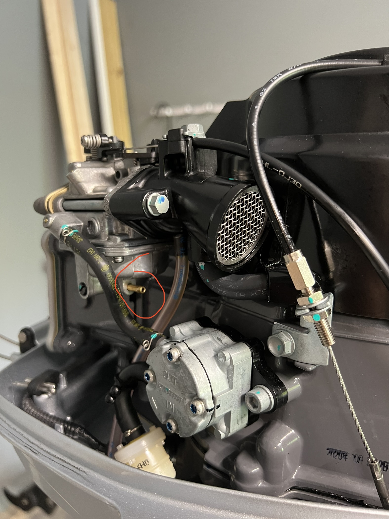

Hey jgmo, I took at look at all the items and everything seems to be in order - I did notice on the carb there is maybe a missing hose? Take a look at the pic and let me know what you think
I believe that's the carburetor drain spout. And, yes, there should probably be a clear vinyl hose attached there. See item 25 in the link below.
That hose then connects to a drain to the outside of the lower, horizontal portion of the engine cover. The drain location is notated by the number 14 in the link below.
I hope you find where the oil is coming from. It may be from under the flywheel if the upper crankshaft seal has failed in some way. But, that's just a guess.
Good luck
Should have said the receptacle for the carb drain hose is noted by E 14 in the parts illustration.
Sorry if that caused confusion.

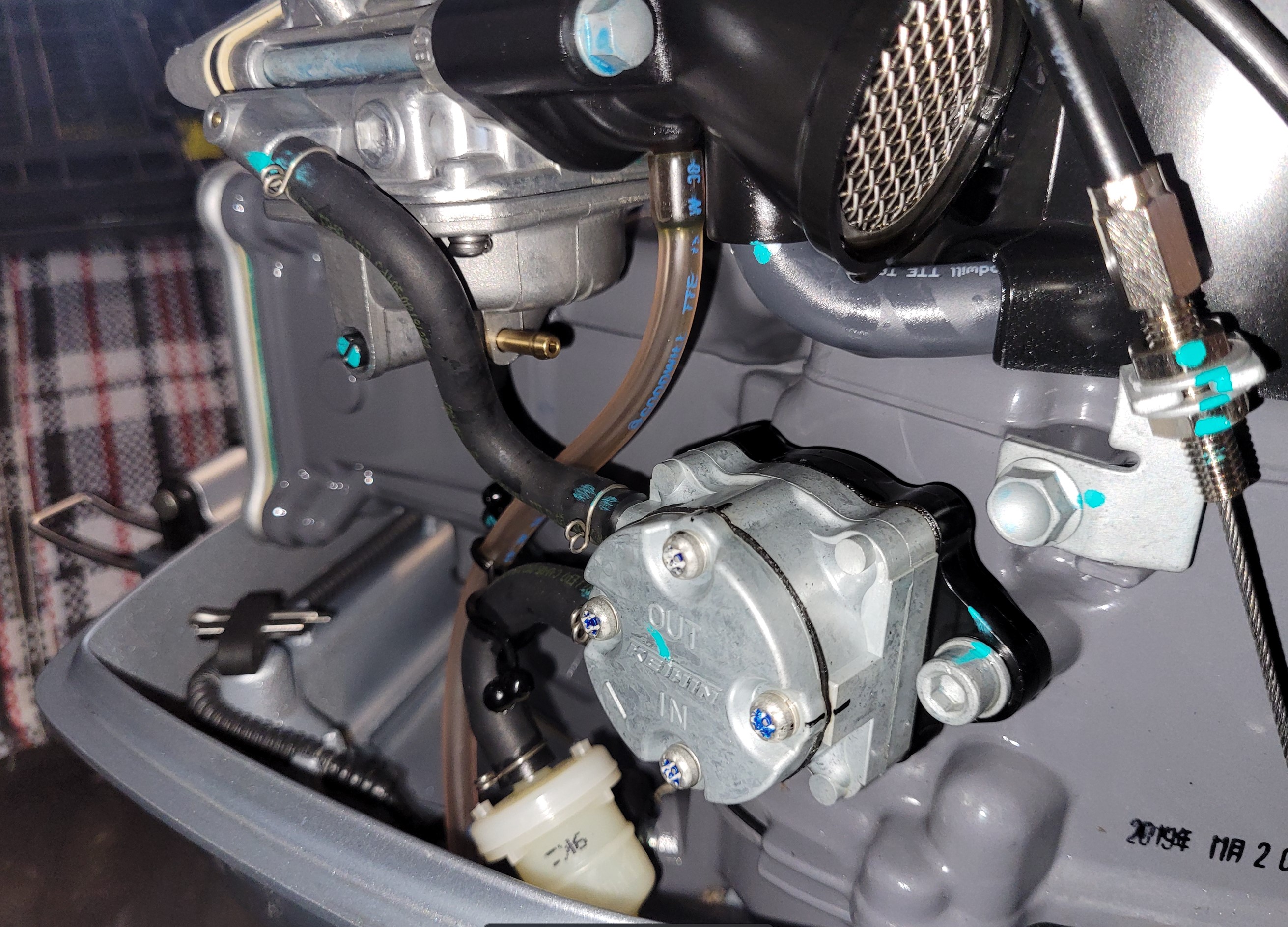

I bought March 2021, similar issue. Oil leaks after transportation on the side. The leg side rubber seal got deformed by oil.
attached pictures there, the oil leak issue is very annoying. I read some posts saying 4 stroke engine no suppose transport in laydown position for long.

I would be frustrated too. Although, I found out long ago that many 4 strokes are going leak oil if transported lying down. No matter what the manufacturer promises.
Could I ask you though, what model (A or D) do you have?
I ask because I see that the crankcase breather systems are slightly different between the two and I think that's where the oil is draining from.
