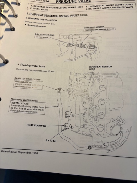

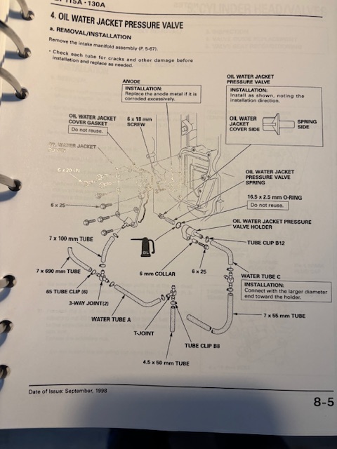

I have 2002 Honda BF130. My unit doesn't even have a tube connected to the nipple on the inside of the cowling, there for no tell tale pee at all. Does anyone here have a diagram of where the water tube should run? When I run the unit, there is no water flowing from inside the cowling to anywhere. I'm confused.
My unit does not have a cooling issue as it does pee below the water line but I'd sure like to see the pee above the water line for piece of mind.

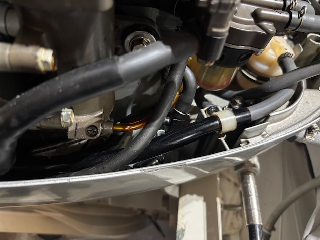

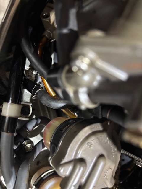

Hard to get a picture of the tubes. Here’s what’s in the manual and a picture on mine.
NSDON
What manual is that? Are there any available for purchase online? Far more detailed than my SELOC manual that's quite disappointing.
