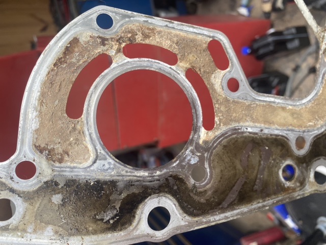

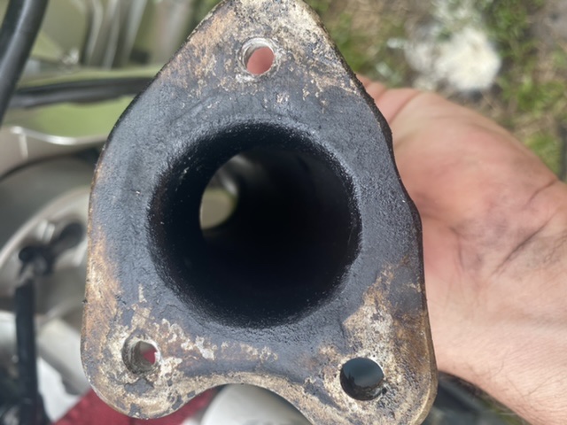

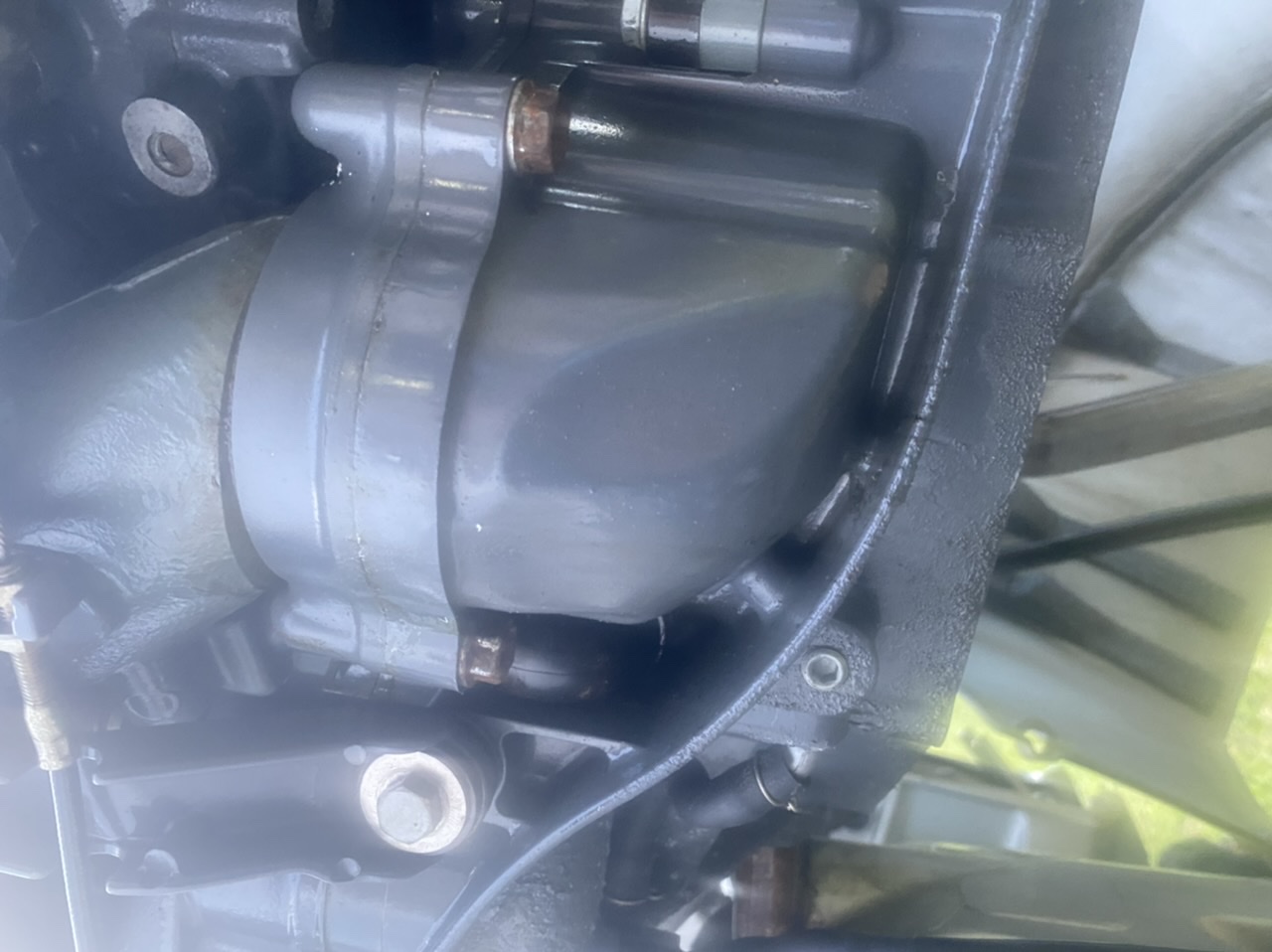

Ok so I got it apart and took the oil pan off. The exhaust pipe on the affected side of the engine had a massive exhaust leak and it was blowing directly onto the oilpan. The inside of the oilpan was correspondingly dark and even in the water jacket there was evidence of overheating. But, there was no massive evide BB6BB137-FD95-41C1-B745-D8099D20DFCA.jpegAA5A07A0-1BA1-457D-AC27-E582BD708B28.jpegnce of leakage however, it just started so perhaps there isn't a stain? Anyway, I believe Im getting water into the oil and vice versa here where the exhaust runs thru the pan and where the waterjacket goes. Ordering all new gaskets then reassembling.0C6BBEF8-FA8C-4A3F-89CA-E472113803D0.jpeg
Ok so I got it apart and took the oil pan off. The exhaust pipe on the affected side of the engine had a massive exhaust leak and it was blowing directly onto the oilpan. The inside of the oilpan was correspondingly dark and even in the water jacket there was evidence of overheating. But, there was no massive evideView attachment 29101View attachment 29102nce of leakage however, it just started so perhaps there isn't a stain? Anyway, I believe Im getting water into the oil and vice versa here where the exhaust runs thru the pan and where the waterjacket goes. Ordering all new gaskets then reassembling.View attachment 29100
So, I ordered a new pan gasket, exhaust gaskets, and the rubber plug for the water tube. Put it all back together, put the boat in the water, it fills the oilpan full of water in ten minutes. This is after replacing the head gaskets on the left head as well. its only getting oil/water mix in the left side of the engine if your are standing behind the motor. Its not getting into the water jacket on the right side so so far I have avoided taking that head off. Somewhere water is coming in under pressure and in the left side cooling jacket and fill the oil pan with water. Anyone have any ideas?
Still stumped. New head gaskets on both heads. New pan gasket. New water tube grommet. I'm wondering if I have either a failed head casting or failed oil pan casting. I'm going to take the foot off and hook a water hose directly to the water tube and pressurize the cooling system to try to see where the water is coming from and how its getting into the oil tank. Oil is also getting into the coolant as its coming out of the exhaust mixed with cooling water.... the saga continues.

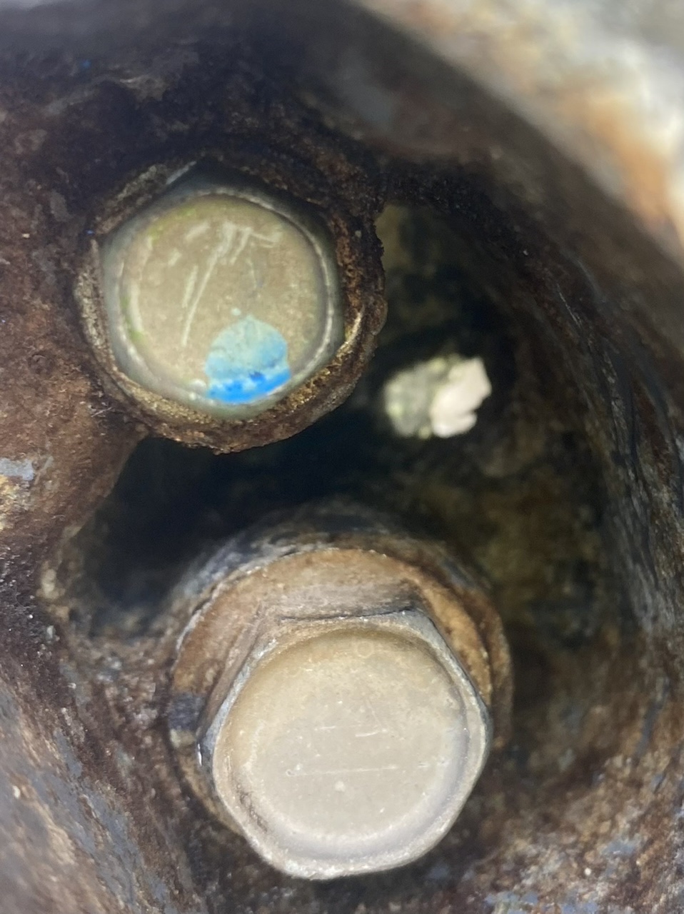

So I believe I hve found the source of my issue. The previous owner had a "mechanic" who worked on the boat. His work was atrocious at best. When they put a new shortblock in the port motor, he did a poor job. When I got the boat, the 2 bolts that hold the housing together under the left side exhaust housing were not installed. I just assumed that the holes were empty castings. They are not. They hold the midcase together. Because the bolts were missing, water pressure eventually separated the cases allowing water under pressure to escape into the oil pan and for oil to enter the cooling jacket on the left side of the engine. I discovered all of this when I purchased another 225 yesterday and it had bolts in those holes. I asked the dealer that I bought the 225 from if the lack of those bolts would cause my issue. He said absolutely. So, after replacing both head gaskets, exhaust gaskets, mid case gaskets, heads, and four oil changes, it was the lack of these two bolts in the midcase under the exhaust manifold that caused the water intrusion.3ACF7C86-AB01-4F79-A931-31E3655F35E0.jpeg

I have the manual. There are alot of empty castings on the bf225. Its hard to know which ones have bolts or supposed to have bolts in them.

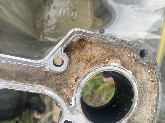

Eureka! By accident I forgot to drain the oil pan before removing the foot and lower case. Oil n water start pouring out of the lower unit. I quickly get it off and shine a light up into the engine. I had it tilted almost all the way up to get the lower unit off. I see where mocha latte is coming out of the drains in the midplate gasket. I pop off the mid case and peel the metal back and can now see my problem. The mid case had a small hole in it from corrosion. Half of a stick of steel stick and no more leaks.... finally solved.
in thr pic I held a flashlight in the oil galley and you can see the hole at the bottom next to the bolts.

Iooking at the picture of that hole in the case the metal looks pretty "thick" there. As in possibly 1/8" or so. Is it? Or is that just my imagination and a trick of the light?

It was pretty thick but it also formed a natural pocket where sedument accumulated and eventually corroded it out. I filled the area with steel stick. The problem is corrosion has already set in so eventually it'll corrode around the epoxy. I plan on replacing the mid mount this winter.
