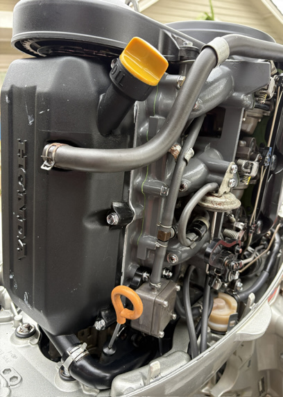

I applied Hondabond and let it set for two days, just run the engine for 15 minutes, the leak is fixed.
If leak returns, I will get a new gasket. I know I should better to get a new gasket, but already ordered the Hondabond and want just give it a try. Very hard to apply a thin layer, gasket is big and need do it quickly. Did cause some mess on the cover.
