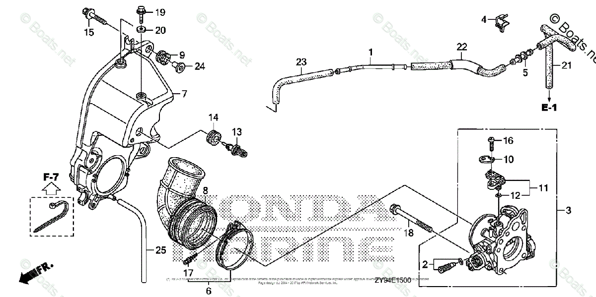

Litle more progress.
I thing i have figured out that if i split nummer 23 from 1 the engine starts. But rough.
I need to open the throttle full, end then the engine revs high, when i lower the throttle one time it came a milky substance from the nr 1 hose.
Just once, but it still is hard to get it to start.
Could it be as easy as the airsensor 13 ?
Is there any software avalible to check the ecu status ?
Well, if there's "milky substance" in the 1 hose then there's bound to be some in hose 22 and that hose gets to the crankcase breather which is located inside the cylinder head cover....item 1 in the link below
I recommend that you remove that cover and the hose and clean all the mlky substance out.
If you haven't changed the oil and filter, I recommend you do that before attempting to run the engine again. You may find "milky substance" (oil mixed with water or fuel or both) inside the engine.
