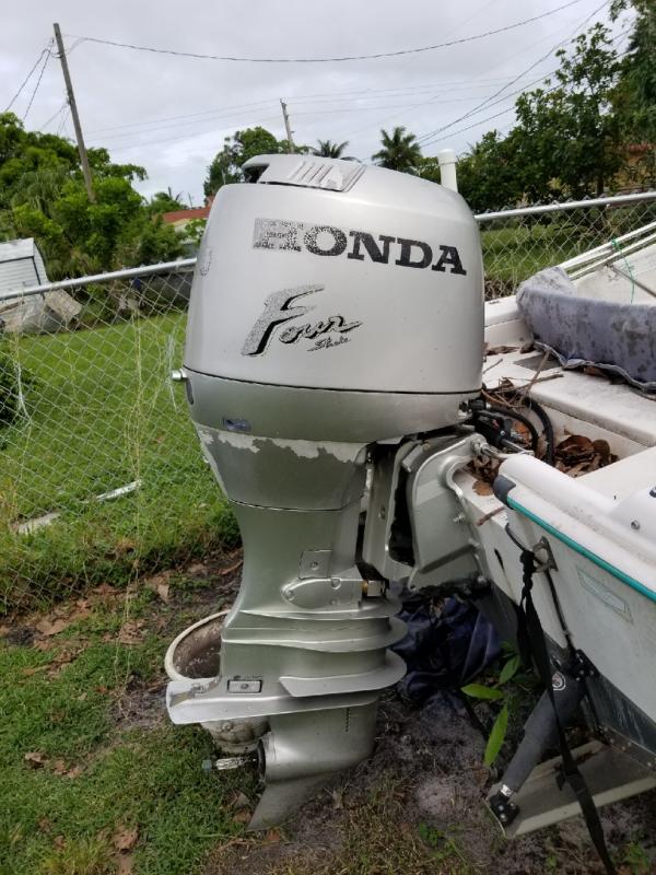

Hello all, I recently bought a boat which has a 1998 BF90A on it. The boat and engine have not run in about 10 years. I purchased it from a friend so I believe I know an accurate history of it. He had some major medical issues back in 2006 and the boat has gone unused since. I went out with him in the boat in 2005, and it ran great in 2005, and I believe that trip (from Ft Lauderdale to FL Keys) was the last time the boat was actually used.
I believe that the engine/boat has less than about 200 hours on it total, but no hour meter. There is virtually no corrosion on the engine, everything appears to be in good shape. I have not run it yet, I need to sort out some of the issues below before I try to start it.

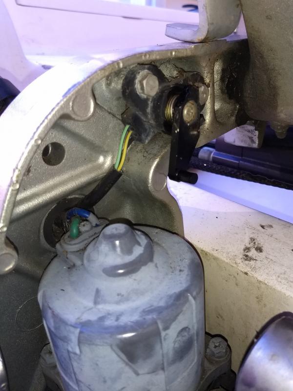

I was able to work on it a little bit this weekend. Got the tilt/trim working. All I did was add a lot of hydraulic fluid and bleed the system by lifting the motor up and down with the tractor bucket. Basically I would lift the engine with the loader while holding the switch to run the motor in the up position, and then drop the engine with the manual bypass valve without touching the button. Had to cycle it up/down maybe 15 times. It's fast with the tractor, I can't imaging anyone doing that with a floor jack, it would take all day. :)
The pump seems a little loud but I don't really know how loud it should be, so I made a video and put it on youtube for some feedback.
https://www.youtube.com/watch?v=MSezzW3LeJU
When the hydraulic cylinder for the tilt circuit gets all the way to the top, it will occasionally stick and not come back down. Sometimes it comes back down, sometimes it does not. It only seems to stick if I let the tilt cylinder travel all the way up to it's end of travel, allowing the cylinder to stop and load the pump at end of travel. After it sticks, if I crack the manual bypass valve very slightly so the pressure bleeds out, and then close the manual valve, it will then come back down by pressing the down button on the cowling. Any ideas? Still needs to be bled more? Normal (doesn't seem so)?
Also, there is a rotary switch on the mounting bracket which does not move on it's own. Looks to be a sensor for up/down tilt/trim position. I can move it with my hand, and after adding a drop of oil, it freed up quite a bit, but still does not move on it's own. I haven't had a chance to find it in the manual yet. Anyone know what it is? Picture attached.

Sounds like a normal Honda T/T operation to me. They are a bit loud.
The mechanism in the thumbnail pictures is the trim sensor arm. It is spring-loaded and should keep pressure on the tilting base until it hits the stopper. Unbolt it. You probably will not need to unplug the wire harness (which is usually up in the cowling) and work the lever up and down using liberal amounts of WD-40 until the arm freely swings up and down. Then grease where the arm rotates on the spindle and the spring mechanism and re-install. I wouldn't let it soak in lubricant because it's likely the seal to the sensor may not be in very good shape.
Assuming you have a trim gauge installed, test if it's working by having someone work the lever and with the switch on. You should see the changes on the trim meter as the lever is moved up and down.
See item 4 at: http://www.boats.net/parts/search/H...0A5 JRTA/STERN BRACKET SWIVEL CASE/parts.html
Thanks for the reply. Am I correct to presume that it only drives a gauge on the dash? That's a pretty spendy part, so if all it does is drive the dash gauge, I'll try to take it apart and make it operational before I spend the $100.
You can usually loosen them up with a little work. Last one I worked on it took about an hour playing with it to get it working smoothly.
Properly trimming your boat while underway is pretty important in terms of comfort and fuel economy. Before trim gauges were prevalent, the typical process was to trim up until the boat started to porpoise, then trim down until it just stopped. With a trim gauge, you can do that once, note the trim gauge reading, and get back to that same position without having to play with the trim every time. Of course all that varies with sea conditions.

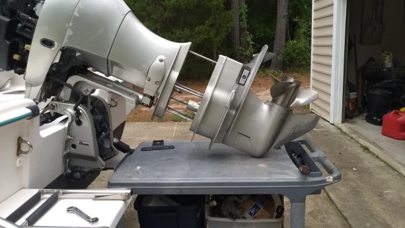

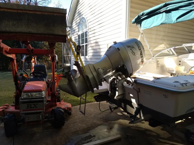

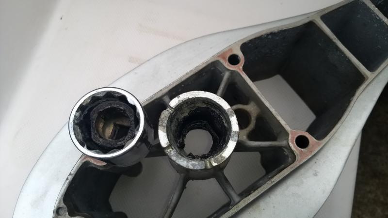

Today I pulled the lower unit off and began to replace the impeller. I bought the Sierra impeller kit for $28 rather than the Honda impeller kit for $120. I figured I would gamble. So far I like the Sierra kit, but I need a few more parts which I did not plan for when I ordered previously.

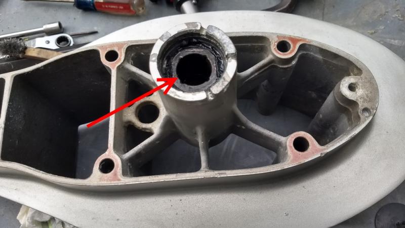

Items 2 and 9:
Basically the c-clip in the intermediate case and the bushing / seal which the c-clip retains. The washer is item 7 I believe, and my washer looks fine. Boats.net does not list items 2, 7 and 9, and I have not searched Google for them yet, I am about to after I post this. The c-clip corroded and broke when I was removing it. I destroyed, or completed the destruction of, the seal and bushing while I was trying to remove the extension case from the shaft. I imagine I can order one of the c-clips from McMaster Carr, but the seal / bushing has me at a loss.
I also figured I would buy number 11, which appears to be the seal between the water pump output and extension case coolant tube.
http://www.boats.net/parts/search/H...LRTA/WATER PUMP VERTICAL SHAFT (1)/parts.html
It appears as if number 15 is the other end of the extension case coolant tube to the mid section coolant tube? Correct or no?
I also do not understand numbers 32, 27, and 29. On my engine, item 6 only has a single seal pressed inside where the shaft goes through. This seal is shot on my engine. I also did not improve the seal condition, while I was cleaning it. The seal surface actually looks fine and it is very flexible still. The problem is that there is junk built up inside where the springs are, and the spring on the bottom is broken, while the top spring is not broken.

After I typed all this, I realized I do NOT have a JRTA engine, I have an XRTA engine. I decided to leave the text above in hopes it helps someone else figure that out more quickly. It's apparently taken me hours...
The water tube which comes out of the water pump and through the separator extension has some rust on the end. How much is too much? I can feel it with my fingers, but it doesn't really scare me. I figure I can put a very thin film of RTV on the end before installing the seal and that will take care of any leak. However, I would even just buy a new tube since it's apart, but I also did not find that one on boats.net. Alternatively, I have a 5/8" diameter 316 SS tube from another project which looks to be exactly the same diameter. I am thinking I can just cut it to length and it will work (?).

Update, swapped the impeller with the Sierra kit, had zero problems with re-using the original stainless impeller housing (so far).
Replaced the bronze busing in the intermediate housing, pressed them in and out with a very carefully used H Frame press and very large diameter sockets.
Swapped the thermostat and cleaned the water flush check valve. If you need orings for the check valve housings, you can buy them from Ace Hardware, they are 1.25" ID by 3/32" thickness.
Flushed the cooling system forwards and backwards, not much came out, which is a good sign. There is really not much corrosion on the engine at all, it was not used much and was flushed after uses, according to my friend from whom I bought it.

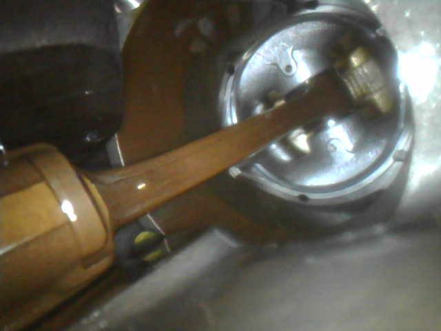

I got out the mini camera and took some pictures of inside the cylinders and in the crankcase as best as I could. There's a couple spots where the walls are not perfect, but for the most part the cylinders look really good. I can only get a picture of the backside of one of the pistons, but also it looks pretty good. After the diesel is done dissolving the sludge I am going to drain it and let the crankcase dry for a couple days with the plugs and filler cap out. After that I am going to put in some sacrificial oil to absorb the diesel and drain. From there I am going to hook up my external oil pump to the remote filter and circulate oil through the bearing system for a while while I spin the motor over by hand. Once that is done I will crank it with no plugs for a bit and just let the oil pump start to flush itself. From there I will change the oil again, and swap on a new filter.

That shot of the connecting rod and inside of the piston has a real clean look.

I was able to fix the trim angle sensor. The trim angle sensor spring had cut a groove in the bottom of the plastic lever arm. I filled that slot in the lever arm with cable ties stacked on top of each other, and ta-da, it works again. :) It's a cheap temporary solution.
