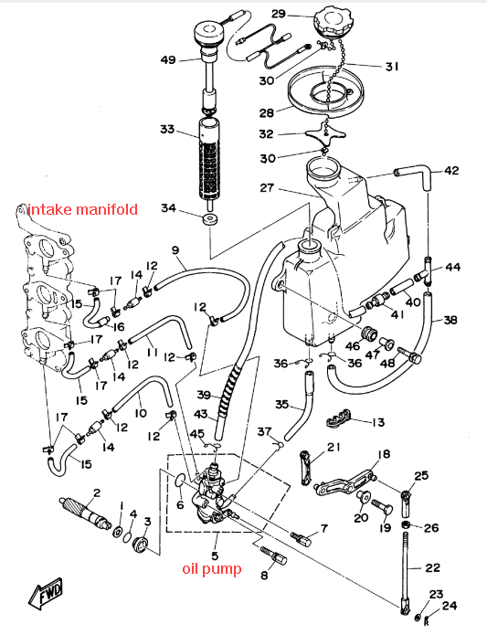

Gasoline is fed into the air intake system. Right behind each carburetor, oil is injected into the intake system by an oil pump. Little bit of oil at idle. More oil as the throttle is opened up.
Result is no different that when premix is used. Just cleaner burn, less smoke, less oil wasted.
Here is what a Yam system would look like.
