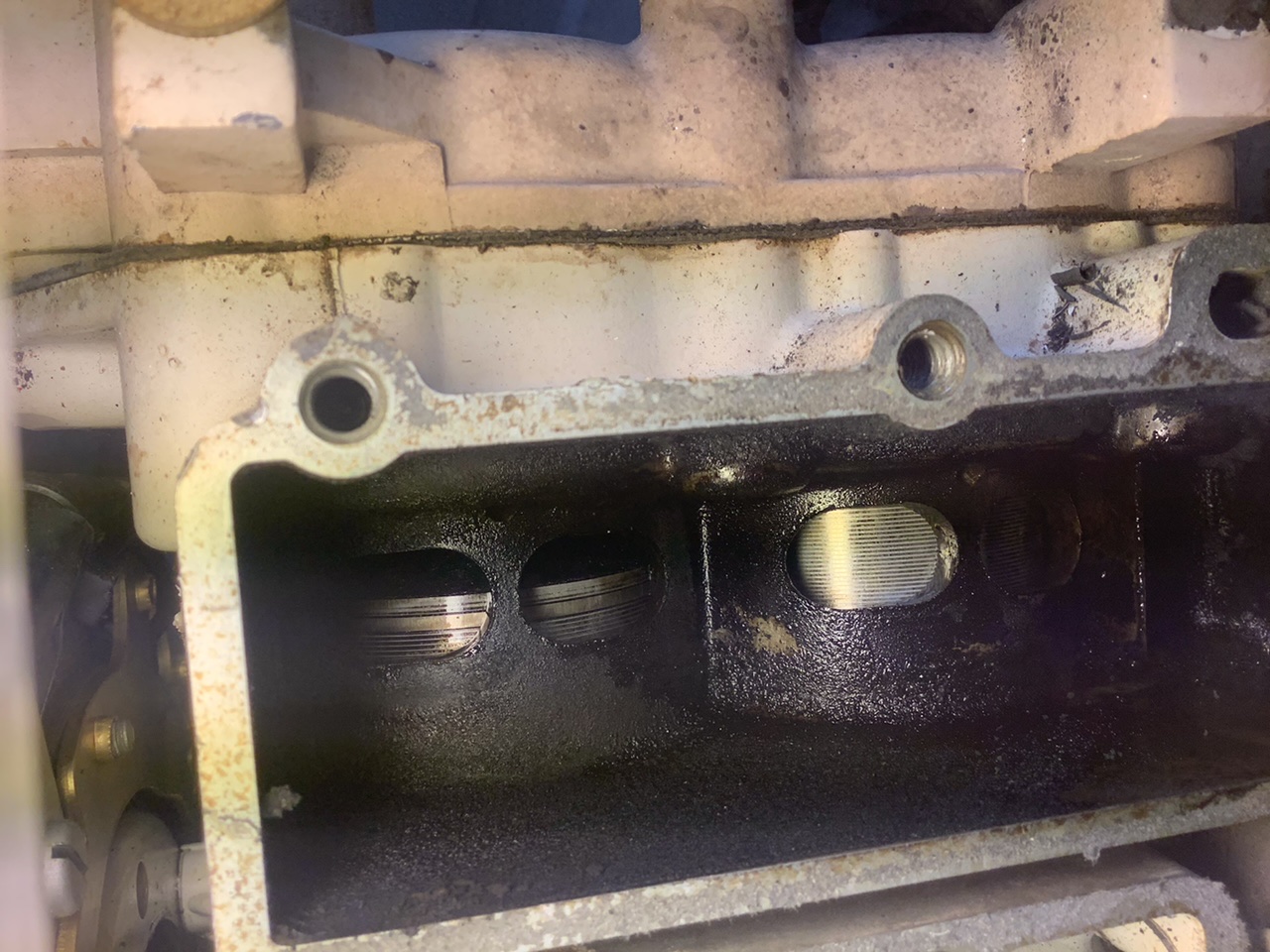

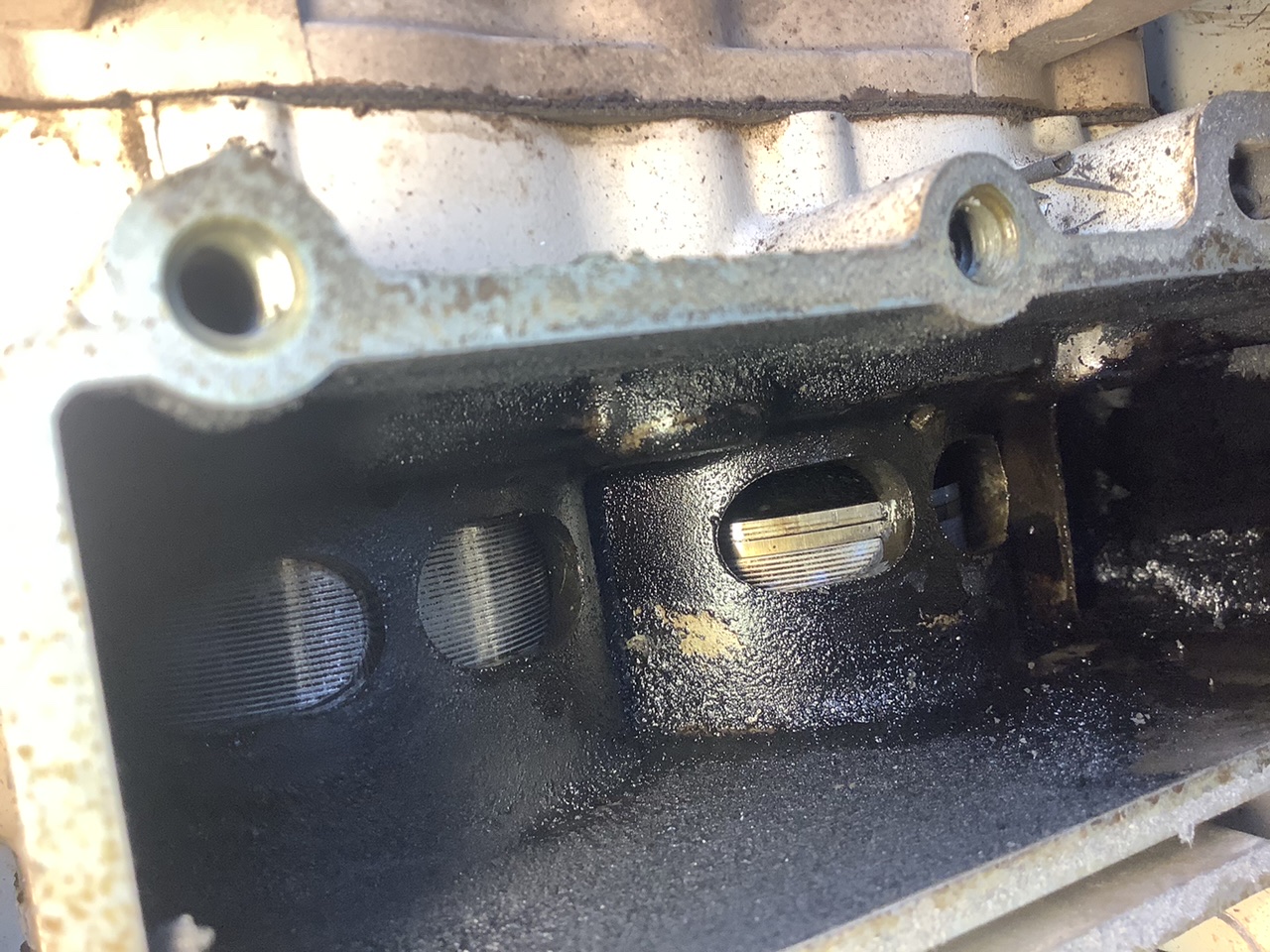

Removed the head, it showed .005” warpage at the Center, between the pistons.
Dug out a sheet of plate glass, some sandpaper, & within 10 minutes had the head decked to within .001”.
put it back on, using the old gasket & some Permatex #3 gasket maker.
Compression is now a needle width over 110 psi both jugs.
That is exactly what my ‘94 Evinrude 8hp shows, so I’m going to purchase new gaskets, clean the carb, do the impeller & get it running.
To elaborate, I know re-using the head gasket, along with some Miracle Shyte gasket maker is not the way to go. I did this
only to see if decking the head fixed the low compression values, which it did.
I intend to clean things up, & obtain new OEM gaskets.
I had removed the exhaust cover, to look at pistons & rings, & will obtain new gaskets there also.

Excellent photos and information, Ed. The rings and pistons look beautiful. What grit paper did you use for that work?
I only had regular 100 grit handy, plus a single sheet of 400 wet/dry automotive paper. I’m not sure if the 400 was necessary, it really only polished the marks left by the 100. I’ve never seen a brand new factory head, so I cannot say how well they finish them, or if a polished surface is in fact necessary.
I used a “figure 8” movement while sanding, to prevent all sanding lines being orientated on the same axis, again, I don’t know if that was required.

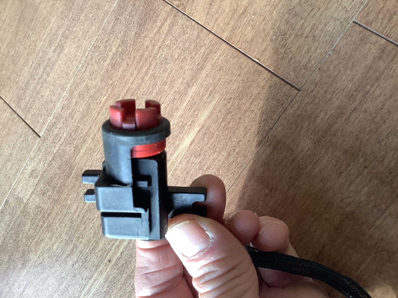

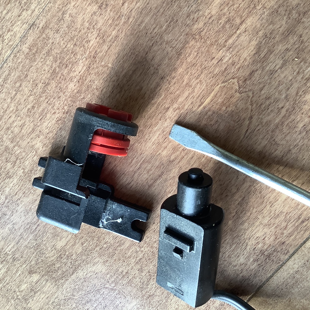

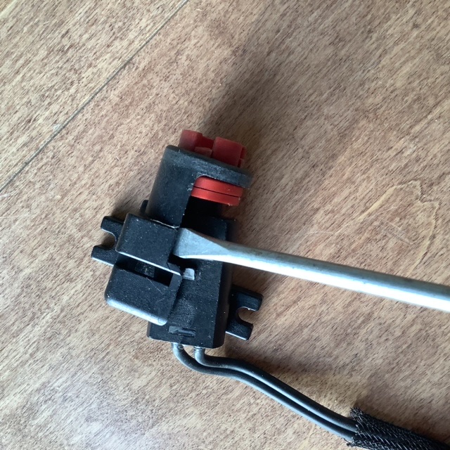

However, upon close observation of the replacement switch, (and being one who leans to the easiest way), these switches bear close resemblance to many automotive switches. There are a couple of small “tits” that actually hold the switch together.
Its actually two pieces that snap together. One part contains the little red buttons, but that’s all it does. The other part is the sealed unit, with a push button that actually makes the connection to ground out the ignition. Using a small flat head screwdriver, in the orientation shown, you can easily split the two pieces.
The RED “button” can then simply be pushed out, inserted into the original fitting, & the two parts snapped back together.
No fishing wires, or splicing if your working pull had the wires cut.
Obviously, this won’t work if the actual sealed switch is bad, but that’s easy to test with a multimeter. If it’s only the “red button”, this makes the job about 10 minutes. You only have to undo the 3 Phillips screws underneath the tiller handle, remove the cover plate, then 2 screws that hold the switch.
