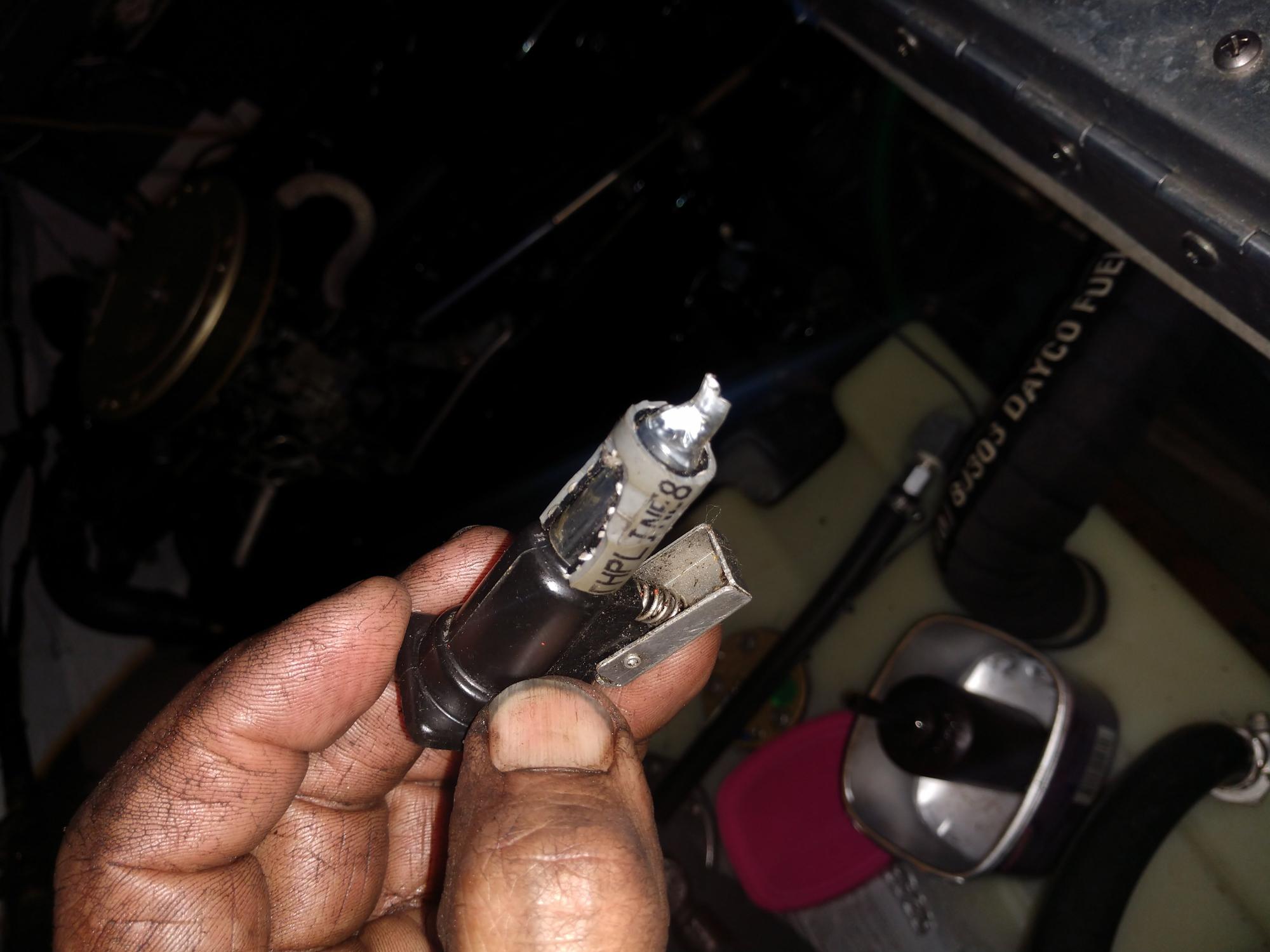

Hi Racer, I'm back. Been out of touch for some time. All good advice. I would not hesitate to add an in line filter to your new non laminated supply hose. Make sure you get a good quality replacement impeller. Most new ones are made of synthetic rubber and barely last a few years. Here is what ethanol does to the grey laminated hoses. IMG_20201108_214815108_compress64.jpg
Here is another example. I see it quite often.

Hi thanks for the reply yes mines gone rock hard and so brittle have no confidence in it so got replacement 8mm 5/16 hose that’s been rated for ethanol so going to replace over the off season all the fuel line in the outboard have been changed for ones like this too. Il stick a inline fuel filter in.
