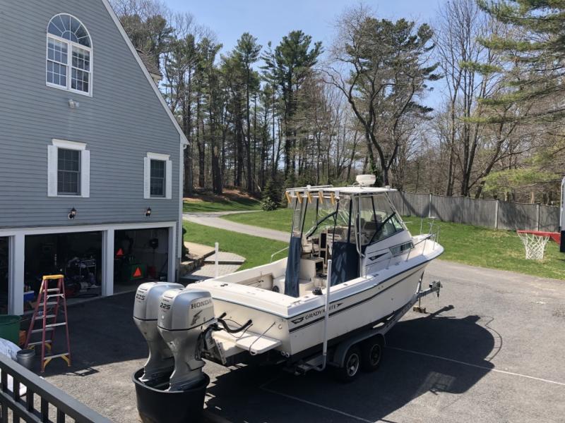

Here’s a pic of the tub. The motors get set into it and trimmed as you see. Then it is filled and hose left on.
Actually.....if it is an airlock, then why steady tell tale?
