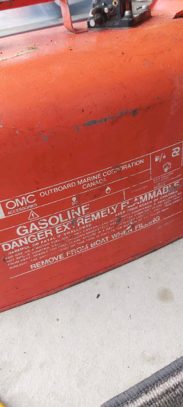

Is this 6gal tank for a two hose setup?
Edchris177
Advanced Contributor
This tank looks to be in good shape, is available for $15, & my fishing buddy wants to get a 6gal one as he only has a little 2gal tank.

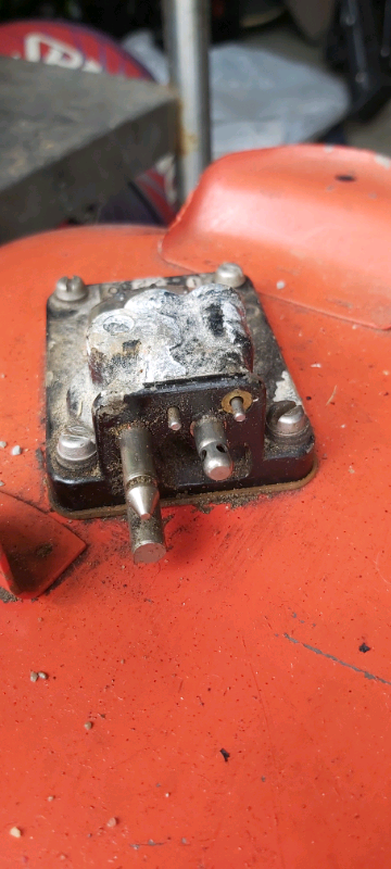

The one I have does not seem to have the two little pins, nor the large pin that is under the locking pin.
will this work with the single Evinrude/Johnson fuel hose connector found on the ‘75 - ‘94 kickers? We have an 8hp, 9.9hp & a 15hp.

It is for a single hose ( non pressure ) set-up.----Those wee pins are valves.----When the hose is not on that fitting the tank is sealed.----When hose is attached the pins are pushed in.----One valve lets fuel out of the tank.---Other valve lets air in.-----These tanks are by far, much better than the plastic junk sold today !----That is a bargain at $15.00.

Yes great tank. Make sure those little pins work....do their job, as Racer described. The tank, in other words, will build pressure with that coupling removed. When the coupling is in place, it creates a shielded "vent"....you will note that little hole angling downward, under the pin that activates the vent. Occasionally these tanks, when they get worn out, will leak out those wee pins....usually just one of them. I've taken these apart carefully and repaired them. Agreed.....These are great engineering....WAY better than plastic tanks.

I picked up the fuel tank today. No rust anywhere, even on the bottom, & pushing each of those wee pins gave an exhale of air, so it seems to be leakproof.
i don’t think it’s seen much use, the little yellow sticker on top is still perfectly readable.
it was also half full, so I essentially got it for free. I don’t know what mix the gas is, or isn’t, so I’ll burn it in the snowblower.
Emptied the gas put today, got a spray of fuel when I pushed the wrong pin, & a whoosh when undoing the cap.
I see now how these are much better than the plastic, these seal tight, & the extra pin, below the locking pin gives more security to the fuel hose.
The inside looks like it’s enamelled, I think that is just color reflection from the mixed gas. Anyway if it’s just galvanized, it seems spotless.
i had to look very closely to see that little vent hole Tim described, didn’t know about that.

When the fuel connector is plugged onto the tank, it normally appears to be a unusual fit, loose, sort of sloppy, whereas one might think it's not pressing those small valve pins in. That's common, and if you can pump the fuel bulb properly, it's plugged in properly.
If there's any leakage at the connection and it proves to be one of the pins on the tank-fitting assembly, "O Rings" & "Core Plugs" are available at "This Site" or any reliable dealership whereas a knowledgeable person can repair that easily (No Big Deal!).
Some aftermarket and even OEM connectors get loose and sloppy, as you say, Joe. Have you ever taken a pliers and carefully bend the locking end/tab on the arm to hold the coupling tighter to the tank? This is very effective, especially on the cheaper coupling without the bushing inside the guide pin.

Thanks for that. I got the connector with the tank, & yes, it did seem a bit loose compared to my other newer tanks. I looked at a parts diagram & saw how the Welch plugs retain the springs. It doesn’t leak when inverting the tank, & I got a good hiss of air when opening it, but I’ll have to wait til spring to see if it leaks while attached to motor.
