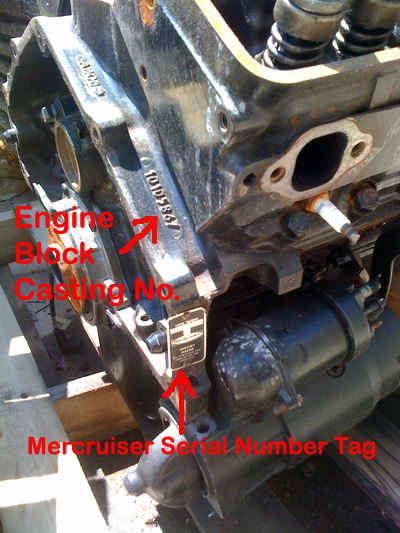

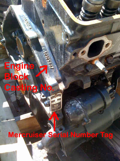

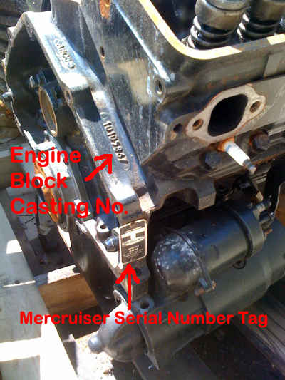

Try to find the MerCruiser serial number just above the engine starter on the rear starboard side of the boat.... Should look like this if it's there,
