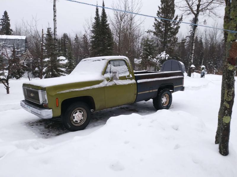

Yup, I think its at least a gallon to pump out all ethanol first to be safe. I put that first gallon in the car or truck. Ethanol should not affect the primer bulbs so quickly, however. I burn ethanol free in my 74 Chev truck too. It runs so much better than on ethanol. I often get comments on how nice that 350 sounds.
