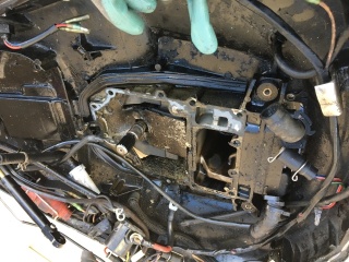

Johnson 90hp v4 blown lower crank seal.
Hey guys thought I share a pic on what the exhaust adapter looks like after the seal started to leak & the oil that was left over from poor combustion & pushed out the exhaust ports. Also the ripple effect in the pan from the pressure spewing out.
