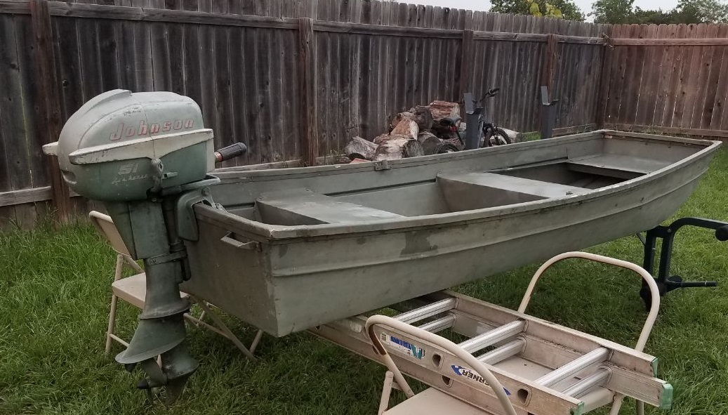

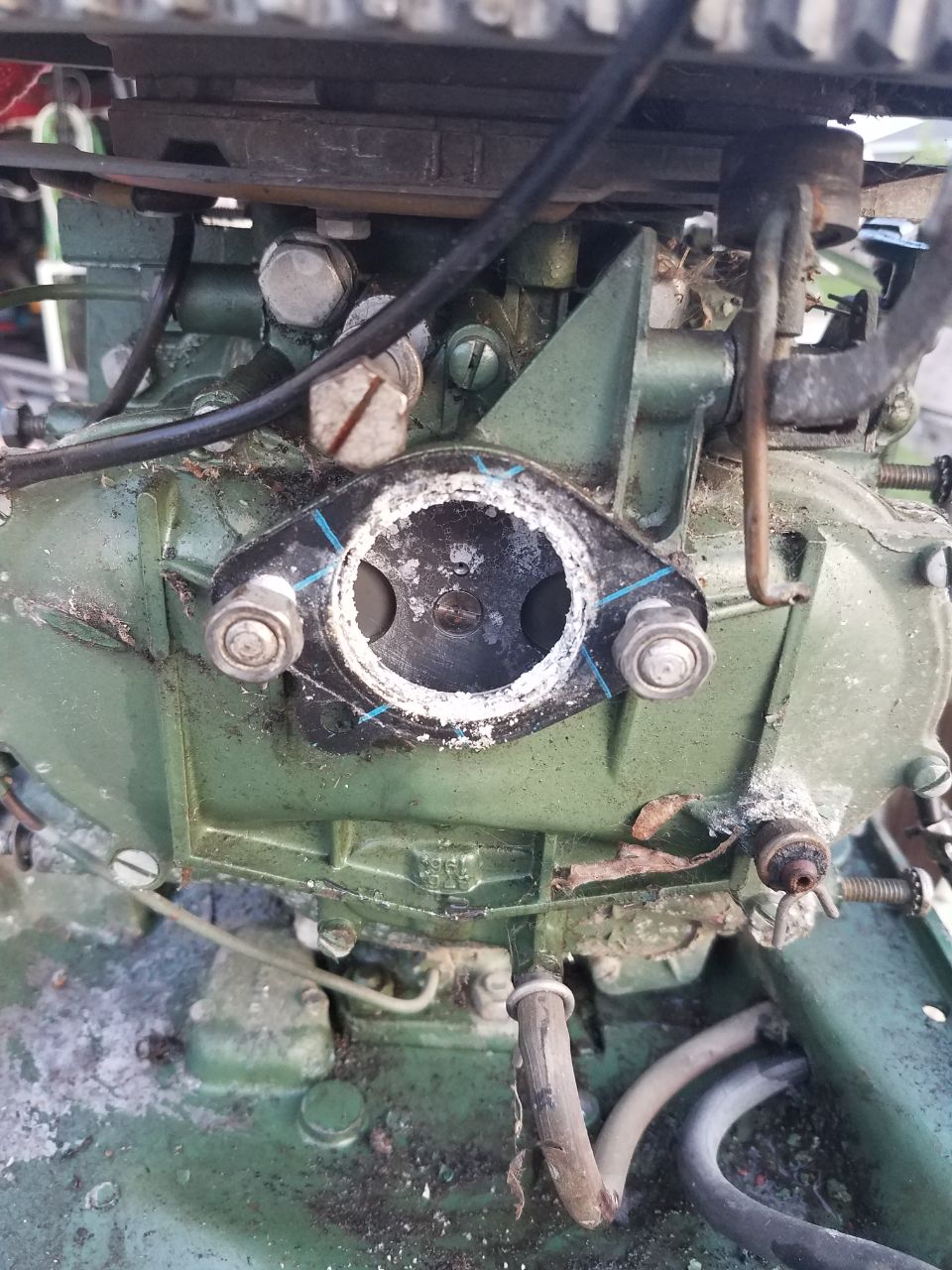

It's locked up solid because it was outdoor decoration, but I'm gonna see what I can do with it. Currently have it taken apart down to the powerhead. I might have to remove it from the lower and split the case to get it free. Being patient and avoiding more damage. It is very similar and still not the same as the 5.5 I am putting the final touches on. I could use a parts catalogue if someone has a pdf.

Location is Texas. If it turns out to be a mess, I don't know if I will rebuild or part it out. Haven't decided yet. Don't see very many of these being offered up for sale.
Yes it looks pretty rough. Might be a parts motor, corrosion has taken its toll. Great motors, however. I have a few of them around that I still use every now and then. A few folks manage to infect them with "modern" ethanol fuel then improperly store them. The results are what you see.
They are cheap, simple and very fun to rebuild. I did my first before I hit my teens, now 58 years later I've learned to love and rely on these beautiful and simple motors....this engineering is basic and brilliant....2 traits that are no longer found today in our engineers.

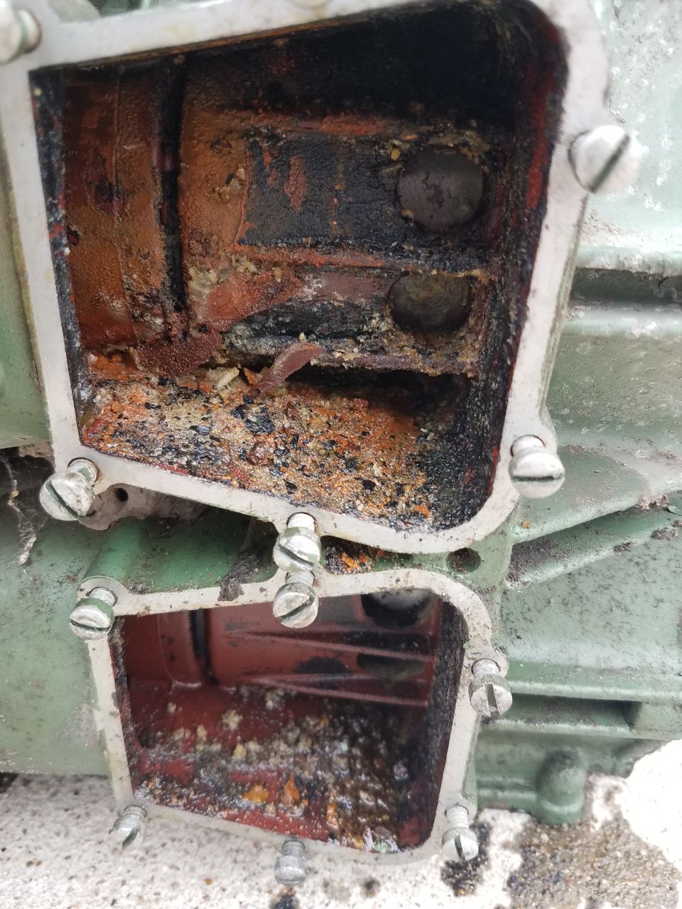

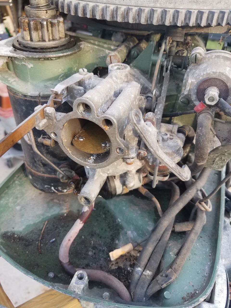

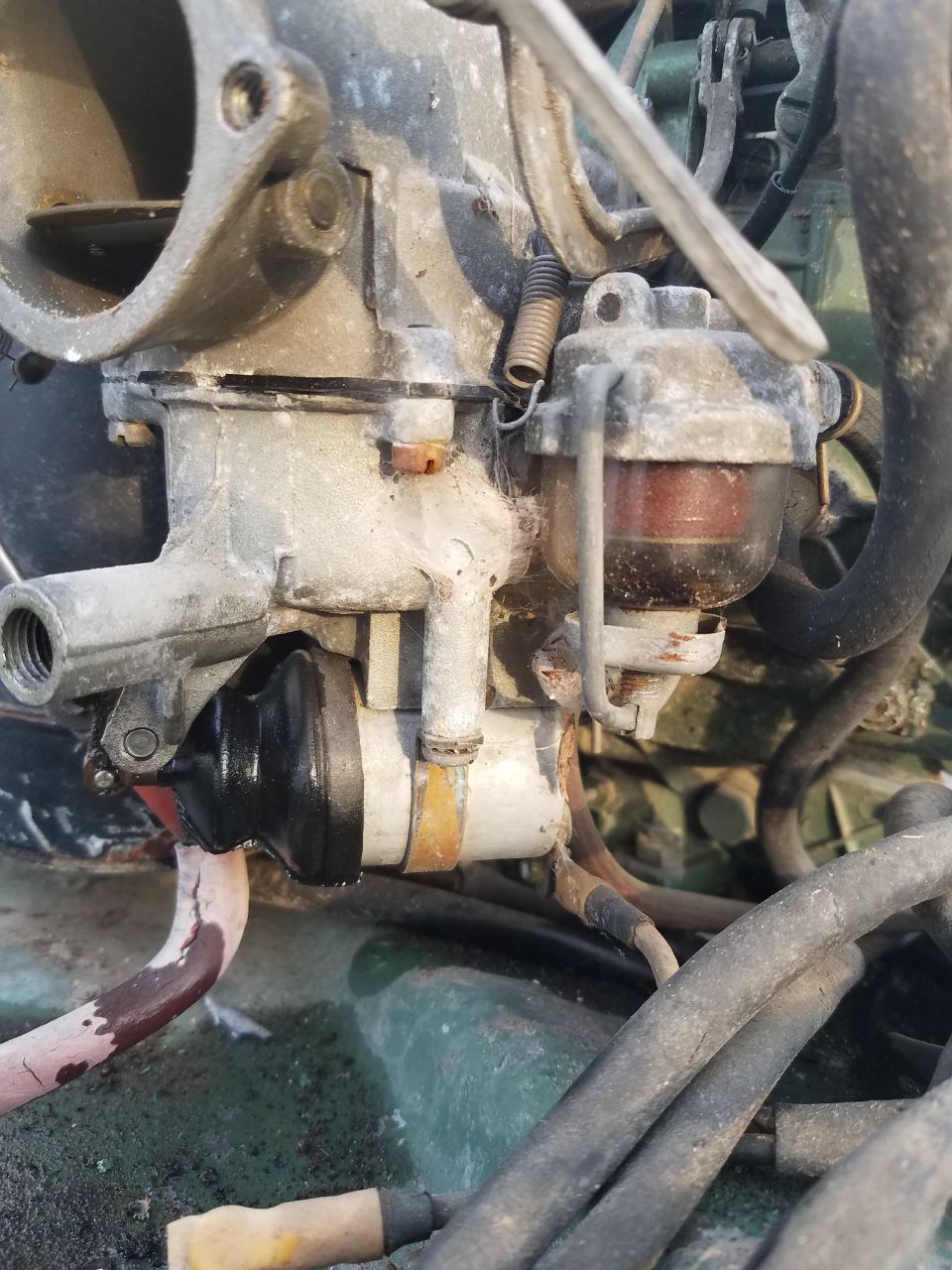

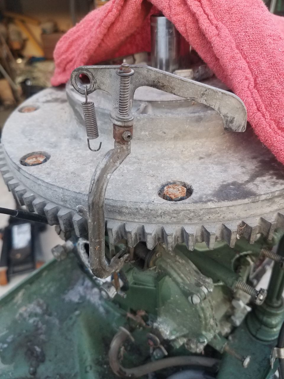

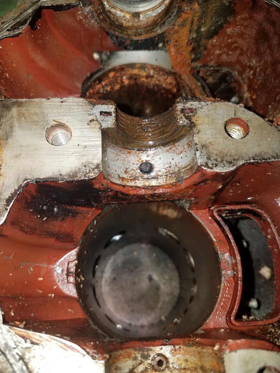

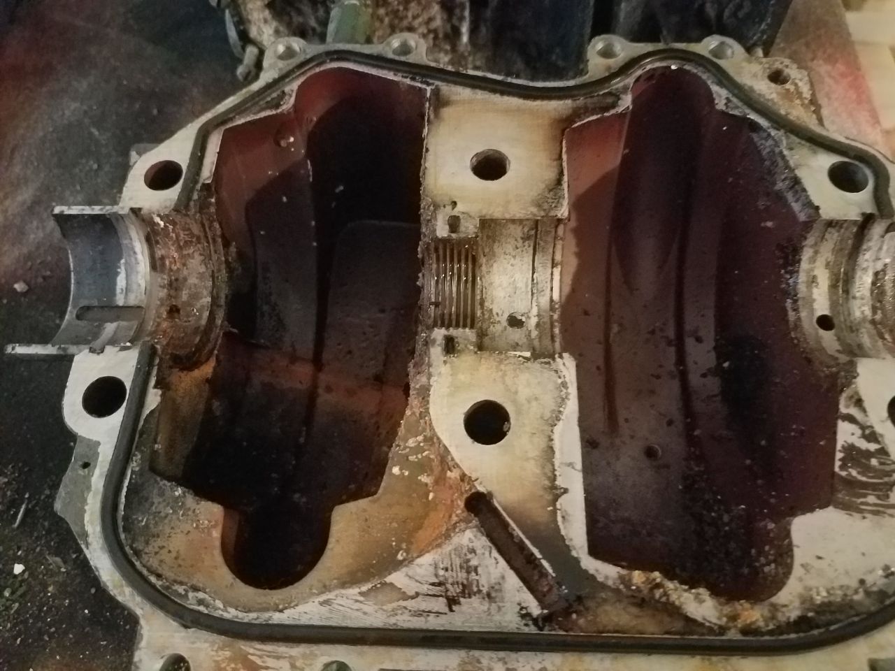

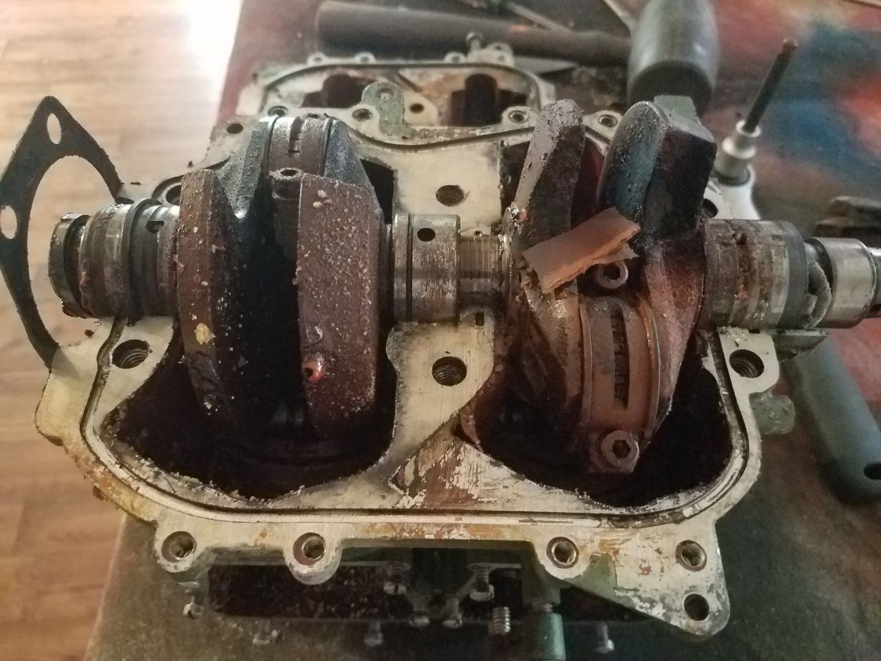

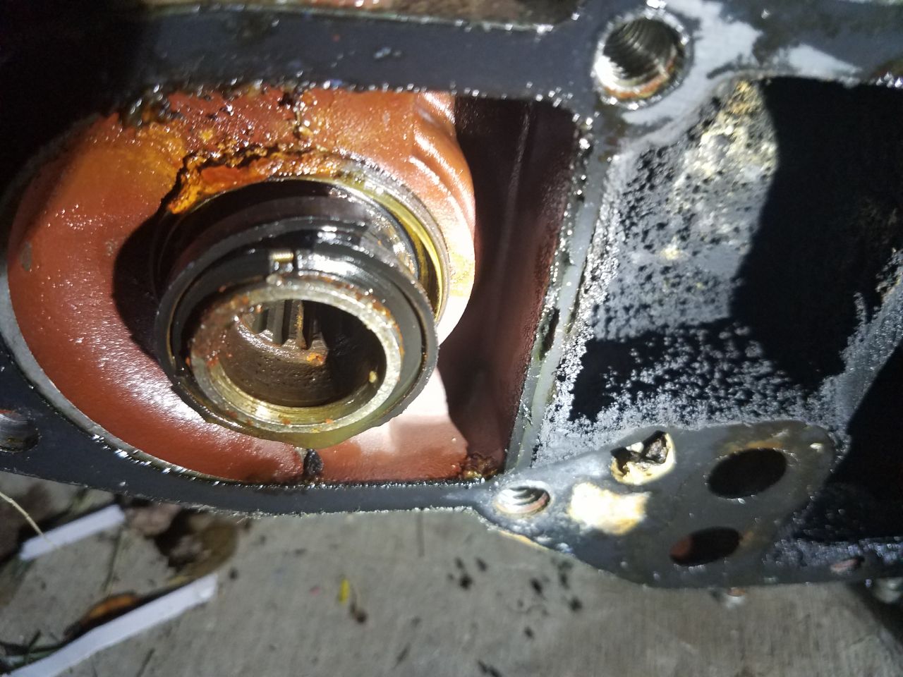

Spent a little more time on it today. The lower shifts correctly. Next step is get the magneto off the top and split the case. Not too familiar with the lower seal, but I think that broken plastic ring might be the low quality seal I've read about.

Great job. The seal is ruined, likely from ethanol. Did you get everything freed up yet? We can fix this, Racer will be a key helper here. We both grew up with these. Great motors.

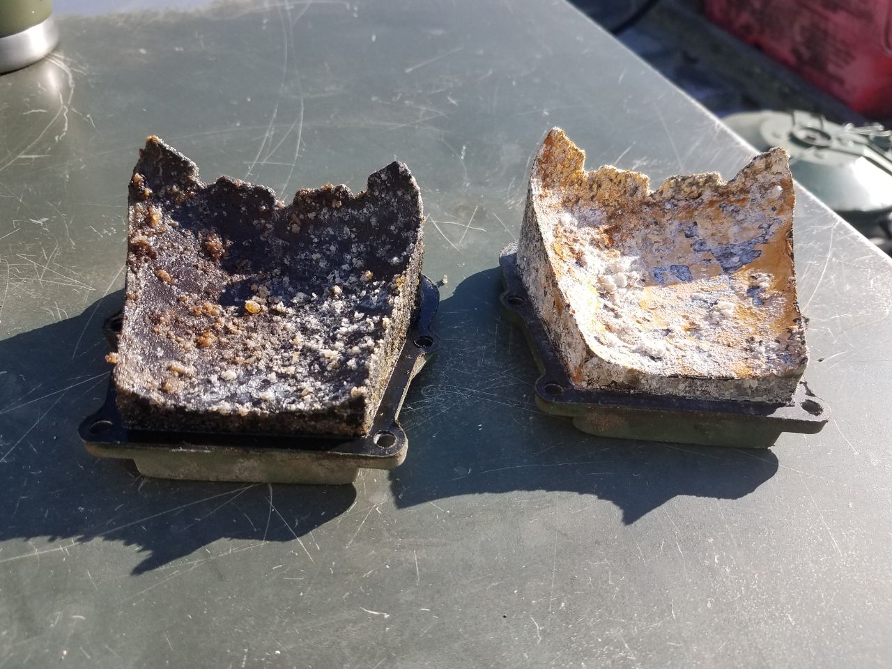

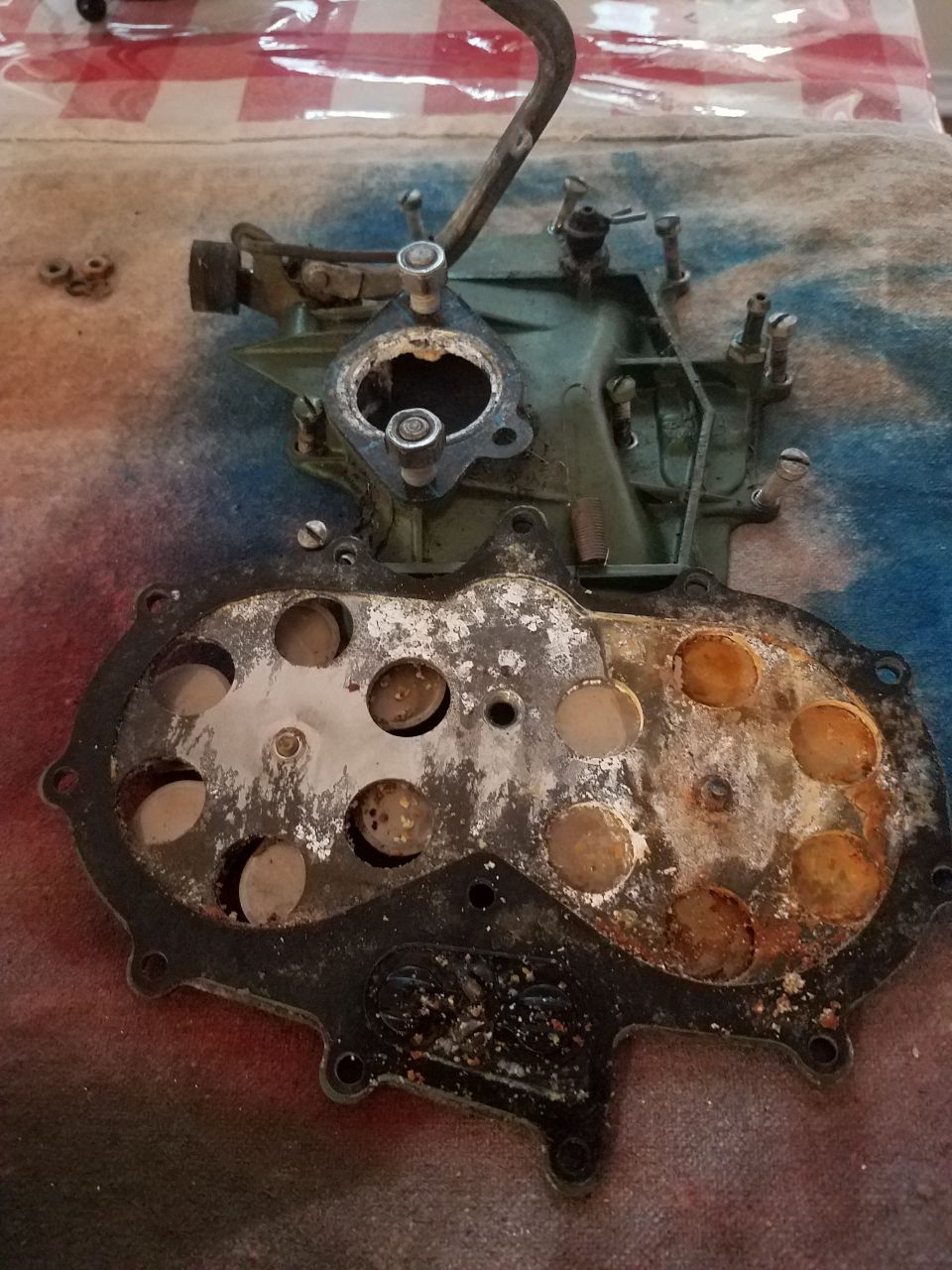

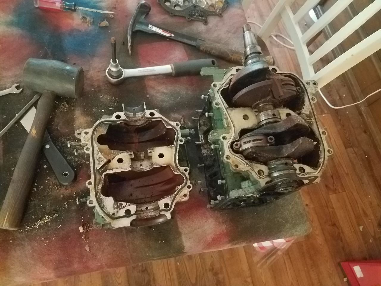

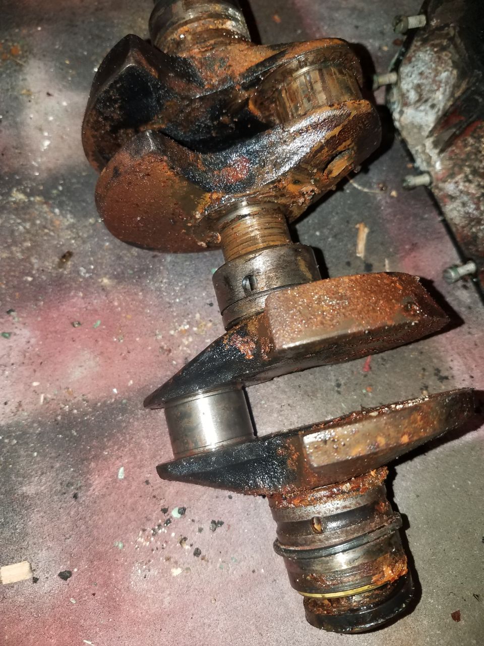

I got it apart. The top cylinder looks much worse than the bottom. I'll get big bucket of solvent or parts cleaner and dunk everything so I can see better.

Gonna need a crankshaft and connecting rod, at least one piston, reed plate, possibly block too, for starters.
