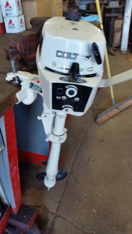

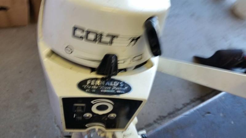

00r0r_uW4bX8ro8o_1200x900.jpgThere doesn't appear to be any knobs on the front for adjusting.
And I think both adjustinh knobs are missing.
Could be racerone. I couldn't see the pictures clearly enough. It just dawned on me that I did have the parts book for that engine so I looked it up. Yep, it does have both a low and high adjustable needle valve. I appreciate the update.
In which case, the carburetor apparently incorporates fixed jets (no adjusting).
EDIT: The knobs are missing. Are the brass needle valves still there?
There aren't any knobs, and I don't think there ever were. It has a plastic insert in the center where the first knob would be. And there is a screw below where the second one is.
In any case, I put gas/oil in it and it fired up on the first pull!
Very strange! My parts book shows that model engine as having two adjustable needle valves but obviously as you've stated above (and the pictures), it does not. At any rate, we're glad that it runs and that you're apparently happy with it.
Parts book shows screwdriver slots in the ends of the needle valves. Hey, this was a very low budget motor. Besides, if it truly is never used, they were adjusted at the factory and do not need anything other than very minor tweaking when you get it on the lake. Maybe not even that.
OK I got it fingered out there are two sets of needle valves. If you want to add the adjustment knobs you need to get the two needles. Or you can just adjust both with a screwdriver just pop the cap off for the slow sped adjustment and the lower one for high speed. They make it nice if your running at different altitudes you just adjust on the fly no tools.
