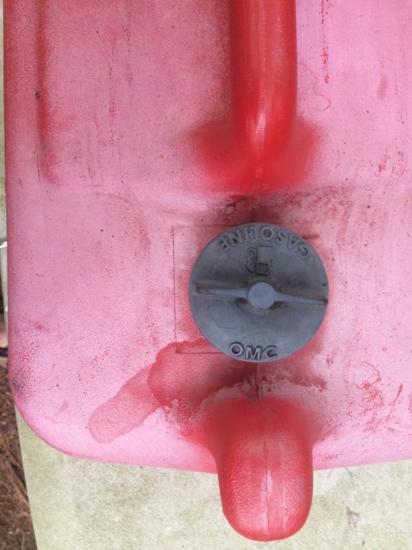

The fuel tank that came with my J25TEEDA is now 22 years old. Today in 90F temperatures I noticed fuel seepage around the housing on the top of the tank. Opening the gas cap slightly eased the problem.

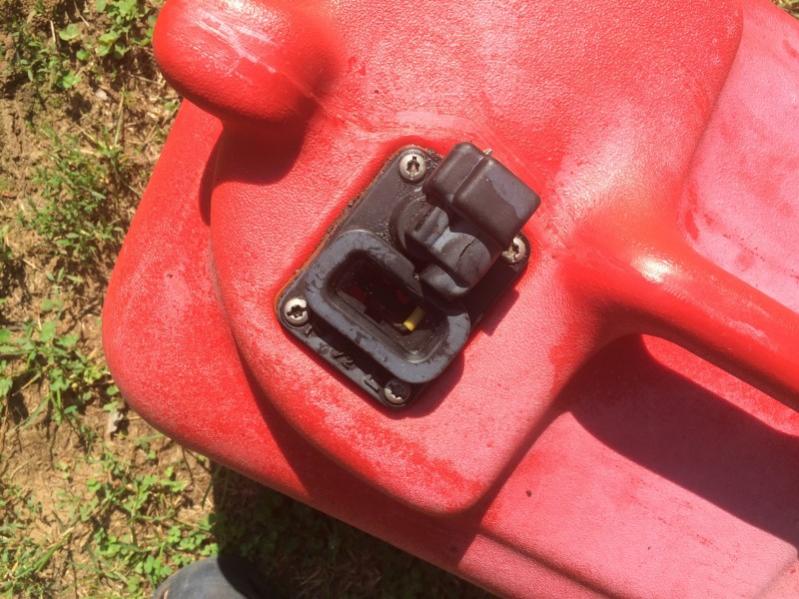

This housing has had a crack in it for some time but I never felt that it led to any leakage. It should be visible in the picture if you can zoom in.

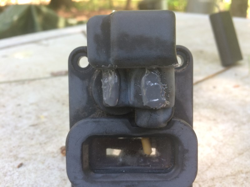

I degreased the tank before disassembly and I found a second crack in the housing. I scratched both cracks with a pick and filed a flat on both sides of each crack. After blowing it clean, applied the J-B Weld.

1 a second crack discovered after degreasing and cleaning

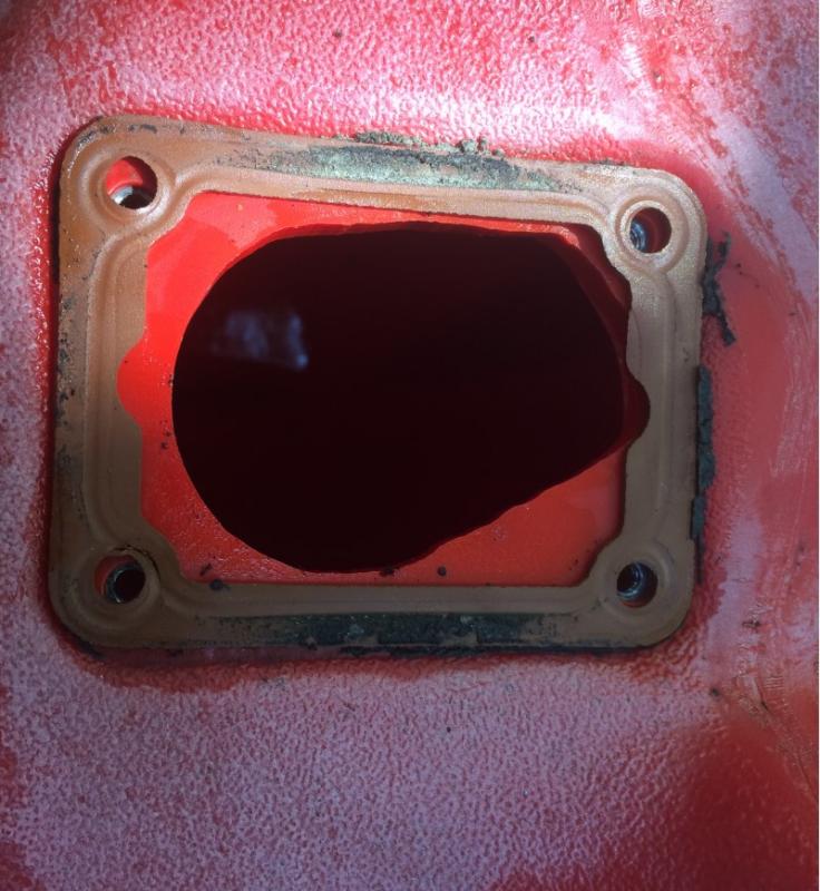

2 looks like the old gasket was doing its job (notice the small tear near one of the screw holes)

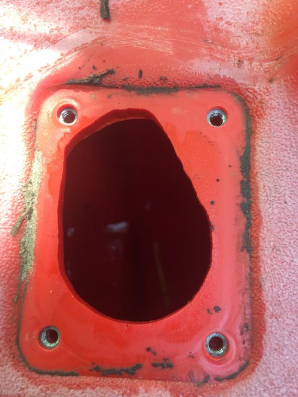

3 very clean surface under the gasket
4 j-b weld repair to both cracks

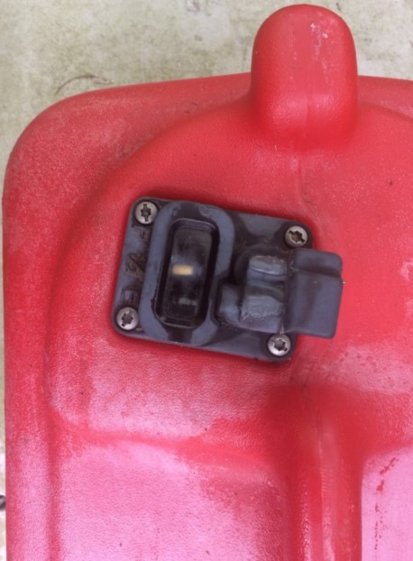

5 reassembled and ready for testing
