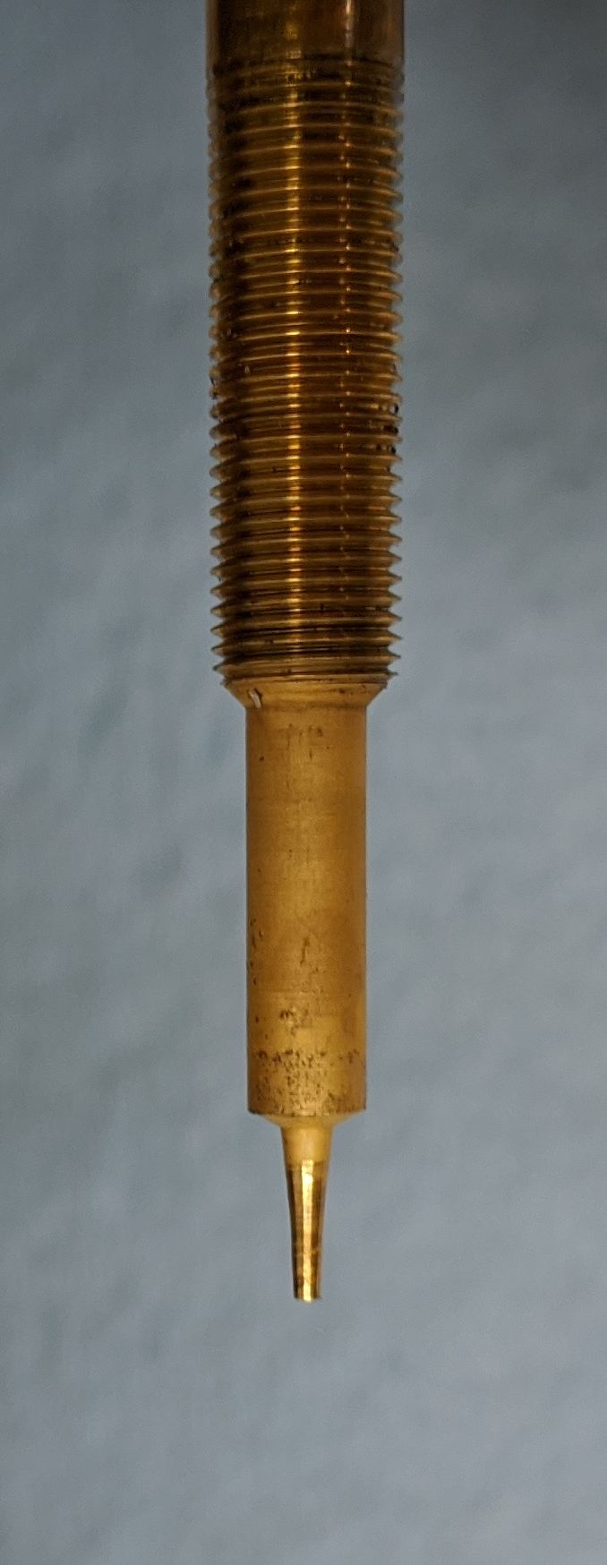

The service manual shows that the low speed needle should look like this:

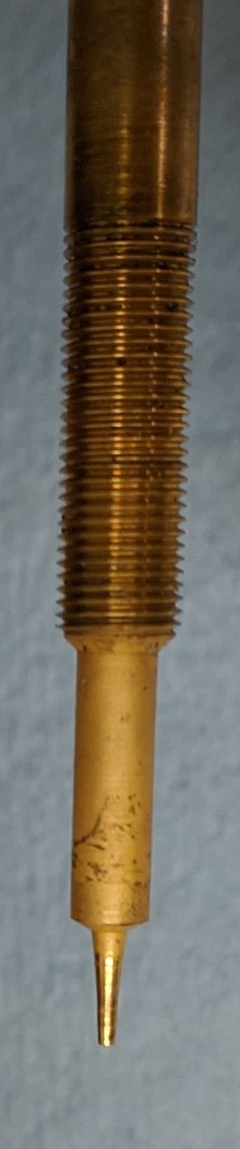

My low speed needle looks like this:
Is the tip of the low speed needle broken off or am I crazy?
