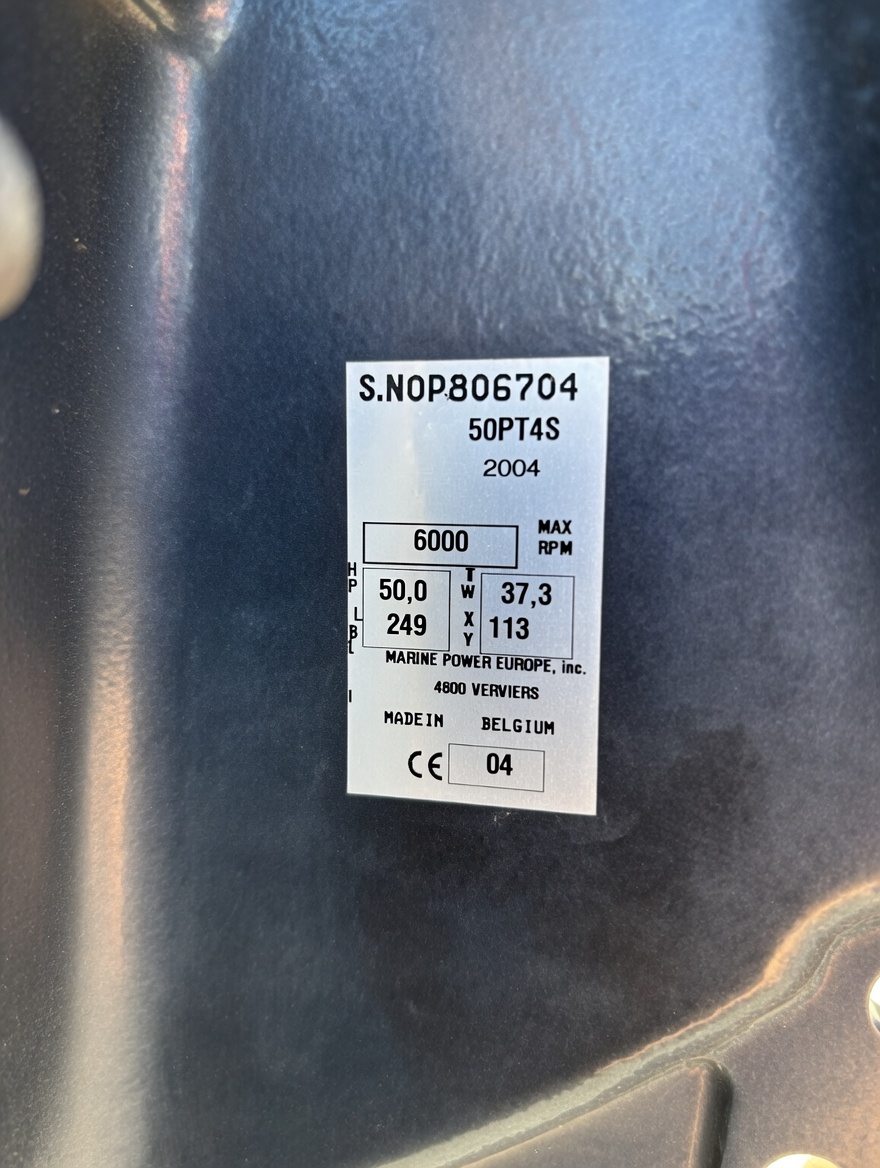

I have a 2004 Mariner EFI 4-stroke 50hp outboard that has developed a serious problem.
