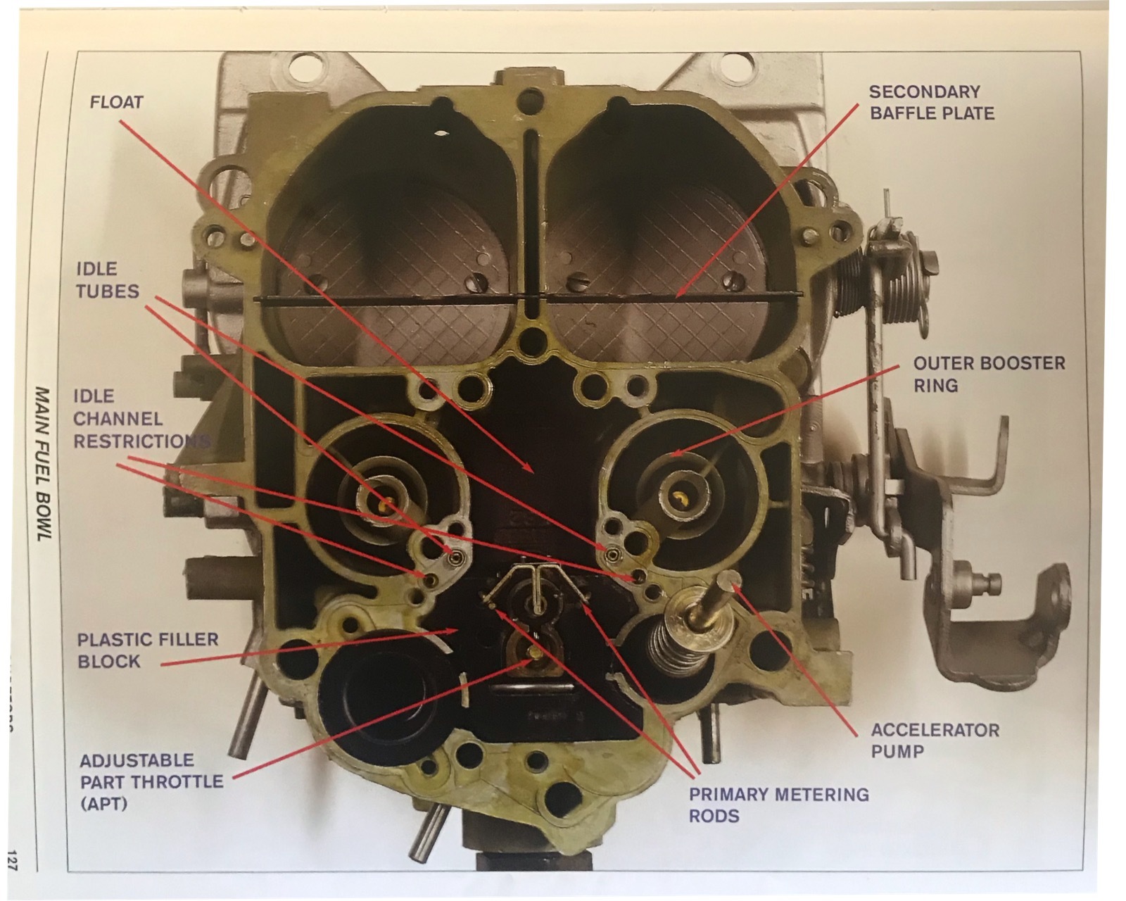

When I did my Quadrajet I soaked it in carb cleaner and blasted it out with a real air compressor not just canned air. You can use a thin wire to ream it out, just be careful. This pic shows where they are on the 4bbl Quadrajet, you have to figure it out for your carb.
