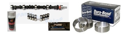

There are a couple of used cams on ebay but always thinking u wanted new.
Delta regrinds and repairs cams with flattened lobes https://deltacam.com/services/repairs/
To interject, check to see if the cam is the same as the standard rotation. I have a suspicion it is as I have only seen two cams and that is a hotter grind for the 485. Yeah I know everyone is going to jump on me here but, please hear me out. If the cam is driven with a direct drive gear off the crank it reverses the direction of it. In the reverse rotation 4 cylinder engine the cam doesn't need to be different as the piston positions don't change relative to each other like a v-6 or V-8. Up down down up stays up down down up and so fourth. What effectively happens in the 470 when you gear drive the cam is only the crank rotates backwards, the cam along with the distributor and oil pump still think they are in a standard rotation engine because they are turning the same direction as they always have. I have yet to see a reverse rotation 470 in person, but check this out as it may be how it was done.
the RH MIE 470s are chain driven, just like the LH versions...the camshafts are no interchangeable between them...
