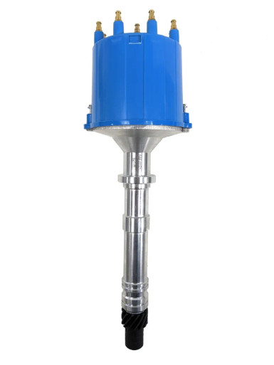

Will this work?
"Restore reliable ignition performance with this complete ignition distributor for GM-based Delco Voyager/EST V8 marine engines used by MerCruiser, Volvo Penta, Indmar, and OMC.
Engineered for a precise fit and dependable operation, this distributor is a direct replacement for worn or faulty original units. It helps ensure reliable starting, smooth engine performance, and consistent ignition timing.
Suitable for a wide range of GM-based V8 marine engines equipped with the Delco Voyager/EST ignition system."

Will this work?
these guy ship intl I think
