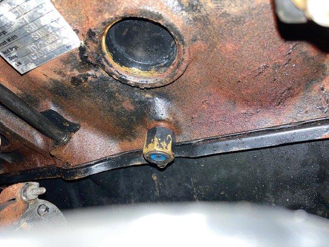

So I was draining my Mag 350 MPI (year 200 model), and as I was re-tightening the one right at the bottom of the engine on the starboard side, it snapped off!
Jeez - I was doing it by feel as I didnt have my light with me, and immediately thought I was in *big* trouble, given the poor access down there. But I grabbed my phone, and took a photo, and actually I think I might get away with this.
The question is - do I try to get the remainder of the drain pug out in situ? If so, how?
Or, do I remove what looks like the nut that the drain plug screws into and tackle it on the bench?
Thanks for any and all advice!
Easiest way is remove the adapter (nut) and then place on a bench to remove plastic plug. Can use a flat tip screw drive or easy out to remove.
Once out replace with same or what's better is use the stainless steel ones from Hardin Marine
PLUGS
be careful removing that, it may just come out but you never know. use a 6 pt box end wrench
soak the threads before you try for a few days with a penetrating oil
toss those stupid plastic drain plugs in the trash and just buy the Merc brass hex head ones that come with the adapter that screws into the block
As Alldodge posted, remove the adapter, along with the others, then buy the correct size brass plugs. I hate the blue plastic ones with the heat of 1000 suns- they cross-thread easier than anything I have ever touched, they break and if dropped, they're gonna stay where they ended up because I'm not diving after them.

Great advice everyone. It's mighty cold, dark and miserable here at the moment so I'll tackle this when it's warmed up a bit.
