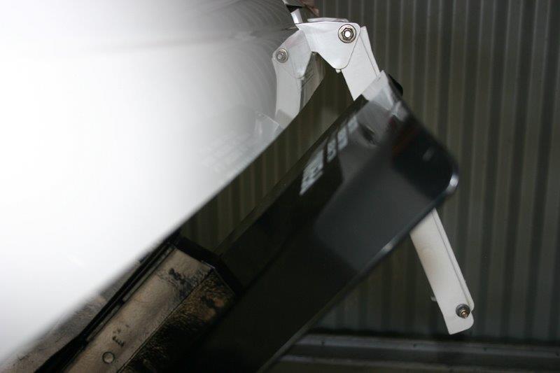

I just bought a Permatrim for my Mercruiser Alpha One Sterndrive. I am about to fit it and realised that once fitted, if I trim my drive all the way up (or out I guess), then the Permatrim will hit the swim platform I have fitted to the back of my Four Winns H180. What I am worried about it, is that when I am on the water and trim the motor all the way up, and forget, then I reckon it will either crack the swim platform or damage the leg/permatrim. I am more worried about the swim platform as to fix it or replace it would cost a lot. My question is, on the leg there is something called a Trim Limit. Can this be 'adjusted' to stop the leg before it hits the swim platform ? If so, how do I adjust it ? I only want to adjust the trim out, and not the trim in, as all the way in is perfect now. Is this possible ? I have attached photos.
In the photo's, I have only trimmed the leg up about 80%, but as you can see, its about to hit the platform. It would have another 4 inches to go easily.
Its a Mercruiser Alpha One Sterndrive on a Four Winns H180 2011 model.

The trim limit only works on the up circuit, maybe its not connected, look to see if there is a black twin cable with two male bullet connectors on the inside of the transom. They should be plugged into the blue /white cable going to the trim pump. When you trim up with the button on the throttle it should cut out when the cylinders are extended around 21 ", then you use a second button to trim up to trailer position. The tilt switch is to prevent the drive trimming out of beyond the support guides while driving.
The trim limit is not intended for the angle your drive is at in the pics, the best solution is look at or fit a trim gauge.
The trim limit switch is to control TRIM, NOT Trailer.
Trim = amount outdrive can be raised while under power to raise boat out of water to achive maximum performance. The trim switch is used to set this hieght and can only be adjusted after water testing. Typical rule of thumb setting is count (one onethousand, two onethousand, three onthousand) and the switch should stop the drive from moving any higher. While water testing if the boat cavitates then the switch needs adjustment.
Trailer = the second botton that will raise the drive all the way up for trailering. (bypasses trim limit switch) NO ADJUSTMENT for any stopping it at a given hieght.
If the hieght with the new fin on is too low to trailer then remove it.
Mercruiser does NOT reccomend installing these on the outdrives...........Affect steering adversly............
If your boat is having difficulty getting on plane then it is a power vs wieght issue and the boat manufacturer is to blame for under powering the boat from the get go........

Ayuh,.... You shouldn't have the drive That high, when In the water, Anyways,....
If ya start the motor, with the trim That high, yer bindin' up the u-joints, 'n will ruin 'em,....

Being a 2011, this should have the two position "up" rocker switch on the control handle. By pushing the rocker switch "up" with little pressure, activates the trim circuit, where the drive will only raise to the upper limit as per the setting of the limit control switch on the out drive. Under normal (on the water) operation you shouldn't hit the swim platform with the trim circuit energized ....you'll get cavitation long before the swim platform is contacted. Pressing the switch "up" a little harder, past the detent, activates the trailer circuit where the drive will raise all the way up...this is where you may encounter problems and hit the platform.
Yes this is exactly right. It has the two position switch. If I depress it lightly, then it only travels about 1/4 of the way out and stops, which is what it is supposed to do. If I depress harder, then it travels all the way out (for trailering). It is at this stage that I am concerned. If I am putting the boat on the trailer and forget to stop the trim before it gets to the end of its stops, then I will hit the swim platform and probably damage it. This is where I want to limit the distance it travels. This is what I hoping to adjust on the trim limit on the port side of the stern drive.
Why did you install this to begin with? It is not needed.
Can I ask everyone's opinion of this? The reason why I fitted it is because when I have a bit of weight in the boat (day 4 adults and 4 kids) and I have a tube behind, the boat really struggles to plane, if at all.. I even distribute the weight evenly throughout the boat (like all kids in the bow, and even adults) and it still struggles to plane. I sit in the water at 45 degrees and the boat will not accelerate at all. It's almost like it has absolutely no power. I was hoping the permatrim would help me plane quicker, and the guys at permatrim (and other boat places) have all said to start with the permatrim and that should solve the problem.

It would be easier for you to under prop your boat for tubing. Take the Trim fin off. They stress the drive and affect steering. No Fin, Lower your prop pitch for tubing and no worries about damage to your platform.
The other alternative is to install adjustable trim tabs, many large boats come with them installed and they are hydraulic. Some are spring loaded.
Although the hydraulic ones typically assist in boat listing, on smaller boats they aid in planning faster. May or may not be an option.
Over all Chris is correct, a smaller pitched prop may be the solution.
there are torque shift (auto and adjustable pitch) props available. They are adjustable and they will act like
example: initially they may be a 15 pitch but at a adjusted setting (usually equates to some rpms like 3200 -3800) and they will mechanically shift to a 19 pitch .
This gives you a hole shot but normal cruising rpms and speed.

Merc sells spacers that go in the trim cylinders to shorten stroke length to prevent a drive from hitting the swim platform. Or you can just use a piece of Aluminum tubing over the rod inside the cylinder on the rod side of the piston.
