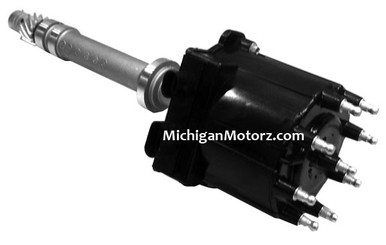

Look on the distributor for a part number.
I doubt the engine has crank sensors, so you need to find out if the distributor is outputting RPM to the ECM- the IC module is in the distributor and that could be the source of the problem, too- it's where the harnesses plug in. If you can have that tested, do it.

The old-school mechanic came by this morning. We ran thru all the previous tests suggested by y'all, plus, he had a spark tester light, which is much easier to use than a multimeter with probes. He put it on a spark plug and cranked the engine. No light. Same test between the coil and distributor: same results. He marked the distributor position, pulled it and took it back to his shop to remove the control module and test the pickup coil. Hoping to hear from him in the next few days. Thanks again for all your help.
Right after I posted above, the mechanic called. He'd had a distributor that he knew was good at the shop and wanted to come by and see if it would solve the problem. My boat is still on the trailer and I had the fake-a-lake hooked up in case we got lucky. He put his distributor in and the engine started on the first crank! We let it run for awhile and It seems all good. The final test will be on the lake this weekend. I couldn't launch it when it wasn't running because my dock is 1/4-mile away from the ramp. The mechanic is somebody I'd heard about a lot because he's a family friend of the guys I ski with. One of them said can we bring him out to ski, and I said of course. I offered to pay him for his time and the distributor. He said "just take me skiing." Keeping my fingers crossed that we solved the problem, with your help of course. :)

Ding Ding Ding! Your diagnosis was spot on! Scroll to the end of the thread to see how it worked out.
