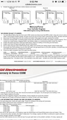

Next I checked all spark plug wires with volt meter-all good. I also switched #4 coil with another. Took for spin and plug still looks brand new. No color at all. That cyl does not seem to be firing when I'm running it. But when I pull plug out and hold it against head and turn motor over, it does produce a spark.
I pulled plug off of cyl 4 coil and traced all wires . I checked for continuity in all of them and all tested good. WhAt else can I test??
