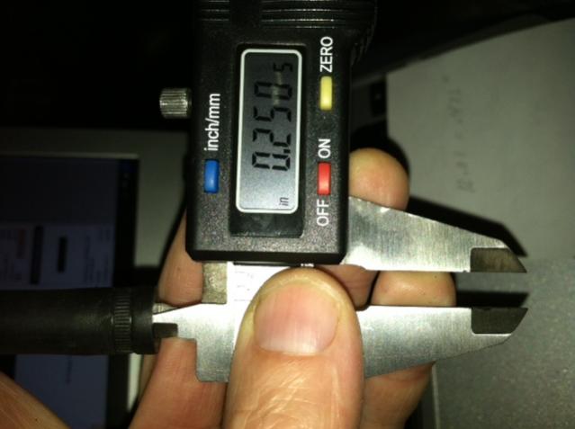

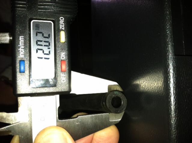

Graham, I think you might have misunderstood what line I'm referring to. I'm referring to the lines inside the cowl, like this one..
I just got a digital caliper and it looks to be .25" (6.36mm) IM.
and .473" (12.01mm) OD.
Does that sound correct? I just want to make sure the calipers are correct, they were pretty cheap...

looks like you got the part and hose out ...take it with you to the store...it should be a tight fit....if you rely on the clamp to tighten a loose fit then it will leak...
I'm still thinking I use 3/8" hose (might be 5/16") - I believe you are getting a 1/4" inside diameter due to it being (crimped) onto the fitting by the hose clamp/zip tie.
You may have the 1/4" line. As you get up in hp I know you use 5/16 and on up in hp 3/8. Varies by engine mfgr., hp, and location in the fuel system.
