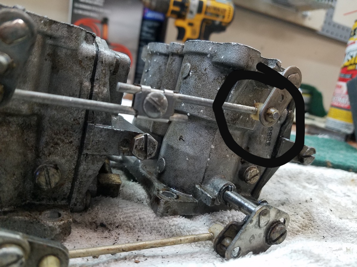

Got the motor all cleaned up. Now for tune-up. Not having any success removing the choke linkage from the lever. Tried squeezing and pressing on the little nylon type bushing with pliers. Worried about over-forcing. Is there a trick?

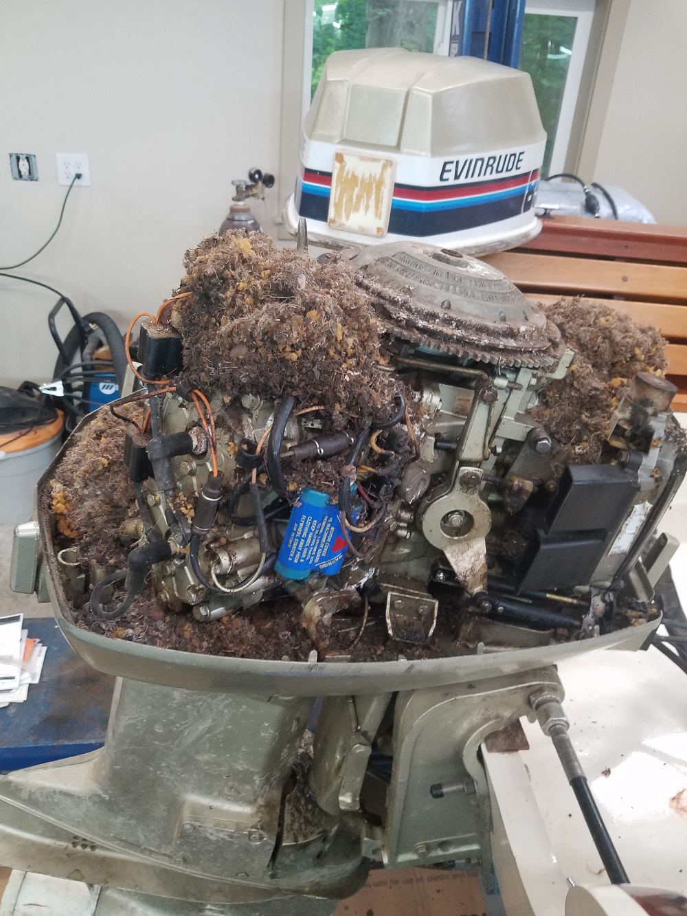

This is what I started with. Mostly nesting material is visible. But mice waste sludge accumulated almost everywhere. Half expected to get the hantavirus.

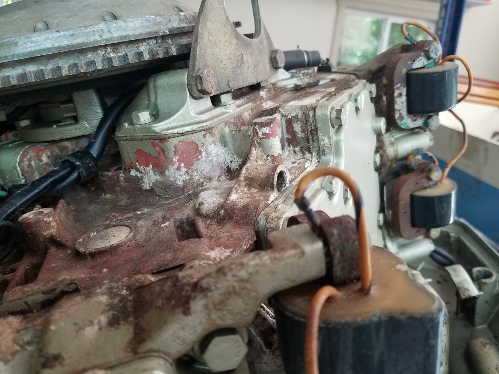

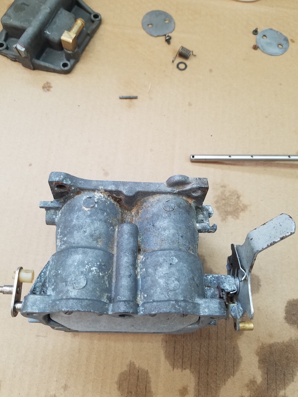

Motor compartment cleaned up now. Carbureators were filthy sticky. Throttle plate on lower wouldn't budge. In cleaning the motor I used a couple cleaning agents (ammonia then pine sol) sprayed on then pressure blasted with clean water. Carbs, once off, were soaked briefly in pine sol solution, rinsed, then in Berrymans for 4 hrs then rinsed with clean water and air pressure.
Now I have white some white crusties on various surfaces. I've cleaned it off a couple times but then comes back. Any advice on this?
Also product advice on lubing the carb linkages. And should I give a light coat of something to passages the throttle lever goes through. It cleaned up pretty good but still bears light signs of corrosion.
Debating with myself whether to pull the flywheel. It's been water and air blasted pretty thorough.
I repair/rebuild a half dozen or so small engine carbs every year. This is my first boat motor carb.
OMG
I've seen that damage plenty when looking for parts for antique cars. Your mice just accelerated the corrosion.
I don't think there's anything you can do other than take everything completely apart and blast it (walnut? soda?) to bare aluminum. Then you're faced with restoring the original coating or giving it all a snazzy paint job.
